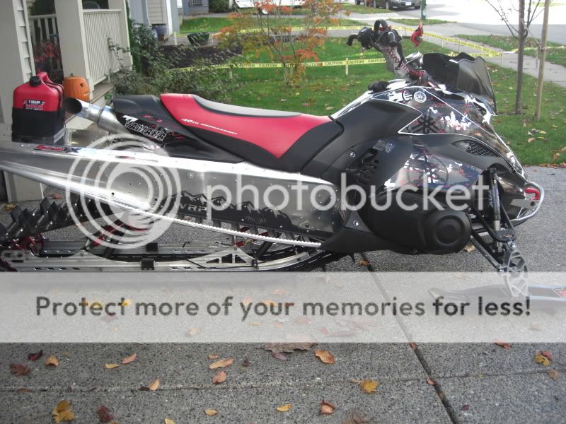

I just got a longer bolt for the front set of wheels and drilled the set hole in the rail, if your talking about the original spring style.
Thats on my APEX MTN, I guess I should really update my sig pic......

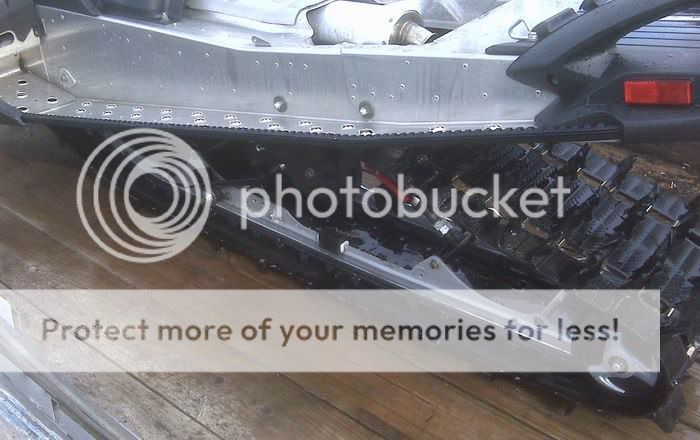

Personally I would just remove your front wheels and mount them in the same holes they come out of. Depending on our rails you may or may not have to drill a hole 2 1/16 in front of the mounting hole for the spring. I have iceage rails on just laid them on the top.
Yamaha does have a mounting bracket so you can keep your front wheels but as long as your scratchers are down you will get enough lubrication and the front wheel is not required.
Anybody who knows me.....knows I have a LOT of experince with scratchers! LOL
See pic
See pic

Here's another tread with some good info and I also have pics of my set-up... http://www.ty4stroke.com/viewtopic.php?t=77442&start=30
