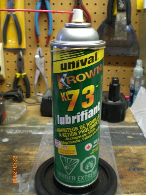

Have you check to see if its not your STEERING LINKAGE starting to seize up, the bushing behind the chaincase and steering post is bad for seizing up and you should also check the 2 PIT ARMS under the air box just spray a good quality lube on all BUSHINGS like KROWN lube every so often I even spray some on my front "A" arm bushings and tie rods...
A quick test is to jack the front end off the ground so the skis don't touch and steer side to side it should be very EASY and smooth I had to take a '05 apart due to lack of lube some get so bad you can hear them SQUEAL, the bushing get very dry.
Here's the lube I'm talking about which you can get at Home Hardware's in Canada or a car body shop that does under coating.
