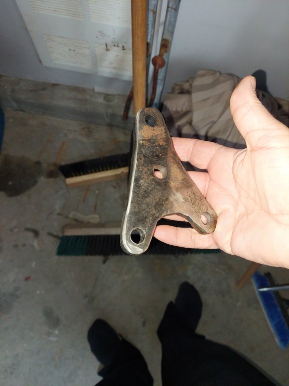

Sorry I misread your post!! I thought the caliper was stuck!!Make a Plate with matching 3 hole as the caliper. And use 3 bolts to pull the caliper off,View attachment 167533
