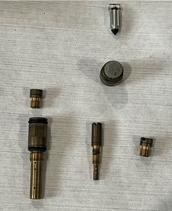

Some clean the carbs without removing the rack but I always found them easier to clean working on the bench. As you can see, the jets are very small and does not take much to clog them or for tarnish to build up:

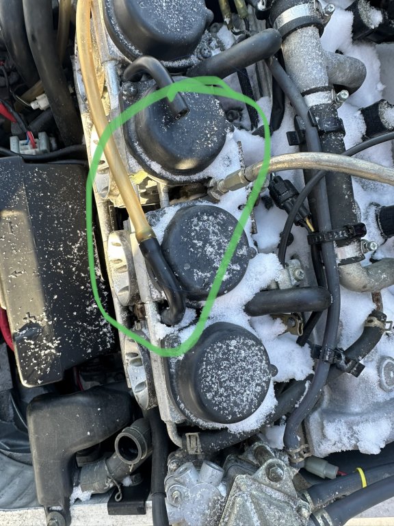

I think I might be missing one of these clear tubes and the tube for the air box
RobX-1
- 2,571
- 1,716
- Coldwater, OH
Both of those two tubes, the one on the carb and the one on the bottom of the air box, just vent to outside so, if anything, just get new sections of hoses to replace but do not think it's causing your no-start.
