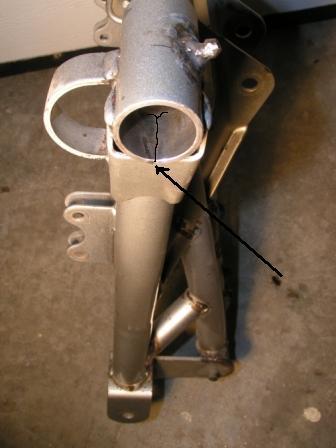

Cracked Pivot Arm
Take a good look inside the pivot arm bushing housings where they bolt to the chasis either side. Mine was cracked badly inside as you can see from the pix. I had stripped the skid for pre season maintainance having done 7000miles last winter. I almost missed it as it is always covered in grease. However seeing the usual rusting taking place I decided to send it for powder coating. When I cleaned everything up for sandblasting here is what I found!

Thank you. Is there any other known places I should carefully examine?

I have a call in to Yamaha - not a whiner -but if you are putting down the power with these sleds the last thing you want is a suspension failure - at ANY speed! This is my own GT and is meticulously maintained. I bottomed it out a couple of times - nothing radical but it looks more to me like a fatigue crack and having covered high mileage (awsome 08 snow!!!) I think it has more to do with material failure.I see the 09 arm is a different part number and is definately beefed up. Have suspension in to HYgear, latest wheels coming and hopefully Yamaha will see the light! and I'll get the 09 arms - even then they are going for sandblasting, inspection of welds and powdercoating after this.
Usual pre season scramble but the machines are awsome and it will soon be snowing!! But dont want to be out in the deep blue yonder, flying along at just over the speed limit wondering if the pivot arm is going to fall apart!!

They changed them in 2008, look at my pic's at the start of this thread...

Yes I went back and took a look at the 08 version that you have -thanks - they have definately beefed it up. Do you know if they changed either of the other two pieces and if the 09 version is any different ?
The quality of the welding and finishing leaves a bit to be desired!!! but I think the powdercoat process will firstly show up any weld faults once its sandblasted and secondly give a more flexible and better protection.

I called Yamaha and they wouldnt admit that there was a general problem. My sled went out of warranty on Jan 08 so they said they could not replace the pivot arm free of charge. I told them that although I have repaired /made good all of the previous faults I felt that a problem of this nature should be taken care of by them especially given the number of sled I have purchased from these people over the last 10 years. Dont get me wrong I was not trying to get something for nothing - like yourself I feel that this is definately a design issue. Neither am I known for my whining !!
They still refused to replace the assembly and I told them I was prepared to shut down 400 acres of trails on land I own surrounding the March Snodeo event at Colebrook State Park NH - during the event - but only to Yamaha sleds - due to my concern over safety. That seemed to get someones attention and they agreed to send me a complete set of parts..... but get this....they could not send me the new updated version for LIABILITY reasons as technically this frame was not designed for my earlier sled!!!!
My friend at the dealership said that it was unlikely I would receive the old unit as the part number had been updated and was impossible to order but sure enough thats what arrived 2 days later !!!! So... in frustration thats when we took to the welding bench and did our own version ( see post with pix).
