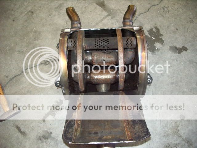

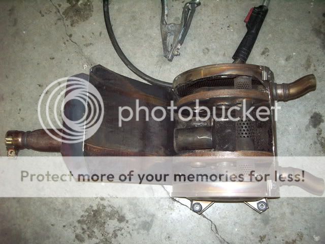

If I am looking at this correctly. The exhaust comes into the middle chamber then enters the tube that runs parallel with the ones you cut and is perforated. It then shoots to the outsides goes into the main pipe and out the opposite side of the muffler. What did you do the first time you made some mods?

Charged RTX said:If I am looking at this correctly. The exhaust comes into the middle chamber then enters the tube that runs parallel with the ones you cut and is perforated. It then shoots to the outsides goes into the main pipe and out the opposite side of the muffler. What did you do the first time you made some mods?
Thats exactly how the exhuast is routed.Once you cut the two tubes out then it just comes in the center then out.Im sure some of the exhaust still goes into the outer chambers but I think this helps to keep the noise level down.Thats why I didnt cut anything else out,to keep noise level down as much as possible and still get the sound I was looking for.
As far as first muffler mod I just cut an opening so that the exhaust didnt have to go through the perforated tubes.Now that the tubes are out what I did originally doesnt matter.Also the first muffler mod just made it ever so slightly louder and had the same sound as stock just slightly deeper.But since I rode another yamaha that was modded with the tubes out I knew thier was a better sound to be had.Heres a picture of the first mod.

If you notice the distance from the outer layer of the muffler to where the tubes sit on my 05 muffler above VS the picture on page 1 (I asume thats from as 03,04)the 03 04 are closer to the top,so it should make it easier to remove them.

My buddy did the exhaust mod to his 06 nytro and it sounded wicked much better than stock, but a week later he came across a great deal on a rumble pack for it and bought it and it sounds great aswell,as a matter of fact i still think the stock mod was just as good or better than the rumble pack but sence then he sold the sled and has the stock mod in the garage collecting dust lol and is now going to sell it so if someone wants one but dont want to cut there stock one up heres your chance make him an offer and i will get back to you as i dont know what he wants for it or what its worth for that matter but im sure someone here do.Here are some pics of it i took before and after.
