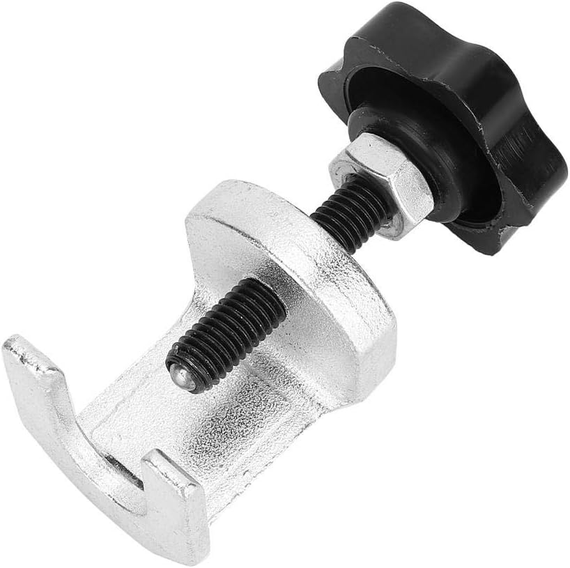

A small 2 jaw gear puller? Maybe a wiper arm removal tool like this would work?
