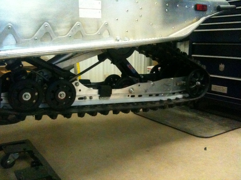

NOTE: I installed the 136" OFT extensions last year and highly recommend another set of idler wheels installed. I purchased an OEM set of idler wheels for a 2009 xtx and installed them just before the rails tip up in the back. Just remove the bolts that are currently holding your rear suspension pivot shaft to your rails, install the wheel and reinstall a longer OEM bolt through the wheel assembly into the pivot shaft. It's really easy.[/quote]
Do you have any pics of this? I'm assuming you had wear on the slides at the bend? I can't see how you wouldn't without the extra wheels. Here is my set up so far.
Where to add extra wheels
I marked the bolt to remove. This is where to install the new wheel for the 136 extension on the nytro. I'll see what I can do for a pic of mine.
Were did u find this bolt? 150 miles on 136 oft and slides are junk . Bought some excell wheels to put there
