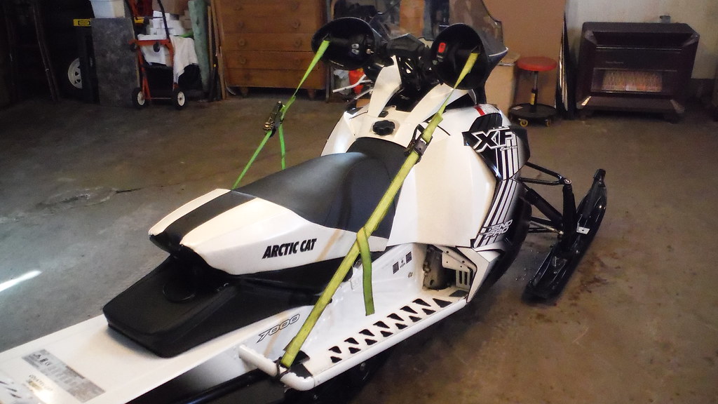

Here's how I do it....
Aligning with the carbide/ski runner is the best reference point. That's what steers the sled.
After skis are parallel to the track, via the long straight edge, tow out 1/16-1/8 measured ski to ski.
Using a tape measure leaves quite a bit of room for error.
This method you can fine tune, watching the changes immediately, as the tie rod is rotated.
Always double check once the jam nuts are secured.
Excellent ski alignment promotes great tracking, little to no darting, and easy steering.

Frozentows that's exactly how we do it as well. One thing I do to get exact measurements is use a framing square, flat side down then butted up to straight bar and up against yard stick. Well done with the photos. We are also a 1/16 or so toe out on each ski.
