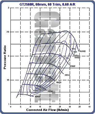

thought this would be a good topic & always wanted to learn myself.so for all the guys that know would love a basic overveiw.iam interested in a new turbo for my tvec & would like to know how to pick one for my application witch is all mountain riding & would like to know why to pick one turbo over the other & why i should use that specific turbo.iam looking to run 15-18lbs boost at 3000-5500ft.here is a couple differnt maps from differnt 2560 turbos that iam considering.

I have no information to offer except that the scaling appears to be different on the very top one, so take that into consideration.

compressor maps
