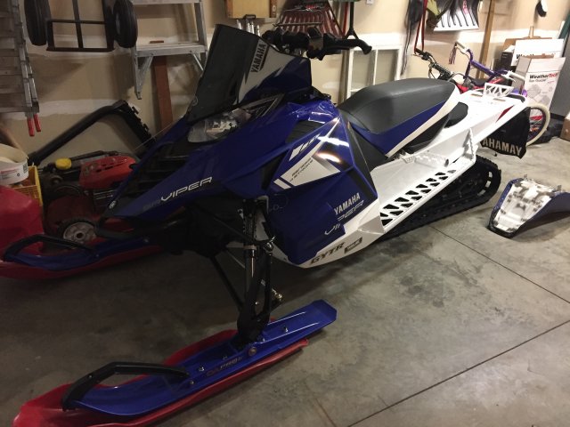

Hey all! I know nothing new but here is my brand new leftover viper LTX so far! I bought this over Labor Day weekend. At just shy of 5k off sticker it's given me some room for mods based off all your guys input of some imperfections. So far, MBRP pipe, ulmer clutch kit, C&A razor's, taller wind shield. On the way is hygear pro dual rate center spring and a LED head light kit. 4th wheel kit probably added soon too. I was going to send out rear shocks right away to Cannondale27 but might ride it 1st to see how bad it really is. And yes it has a mountain seat, no clue why. It was like that at dealership so maybe their mistake but I actually really like the seat. That said! After 6 season on my nytro, Let it snow and hope to see ya all on the trails my Yamaha family! #stayright

Yeehaa let the fun begin! Nice sled!
It must have been special orders with that seat?
2 little things to note for you.
1. When you do your first oil change the filter will be tight as hell, make sure the seal on the filter comes with the filter and doesn't stay on the block. Engines have been lost from this when the new filter is put on with the old seal still stuck to the block.
2. Keep an eye under the chaincase side garage floor. Some 16s leaked and the dealers had to re seal the case. If yours hasn't leaked your likely fine.

Thanks for the heads up!

Trust me I was over 260lbs and the sled rode like a brick.Do yourself a favor and send them to Cannondale.I think you will like the mountain seat it is a little taller.If you dont like it may do a swap if you would like.
