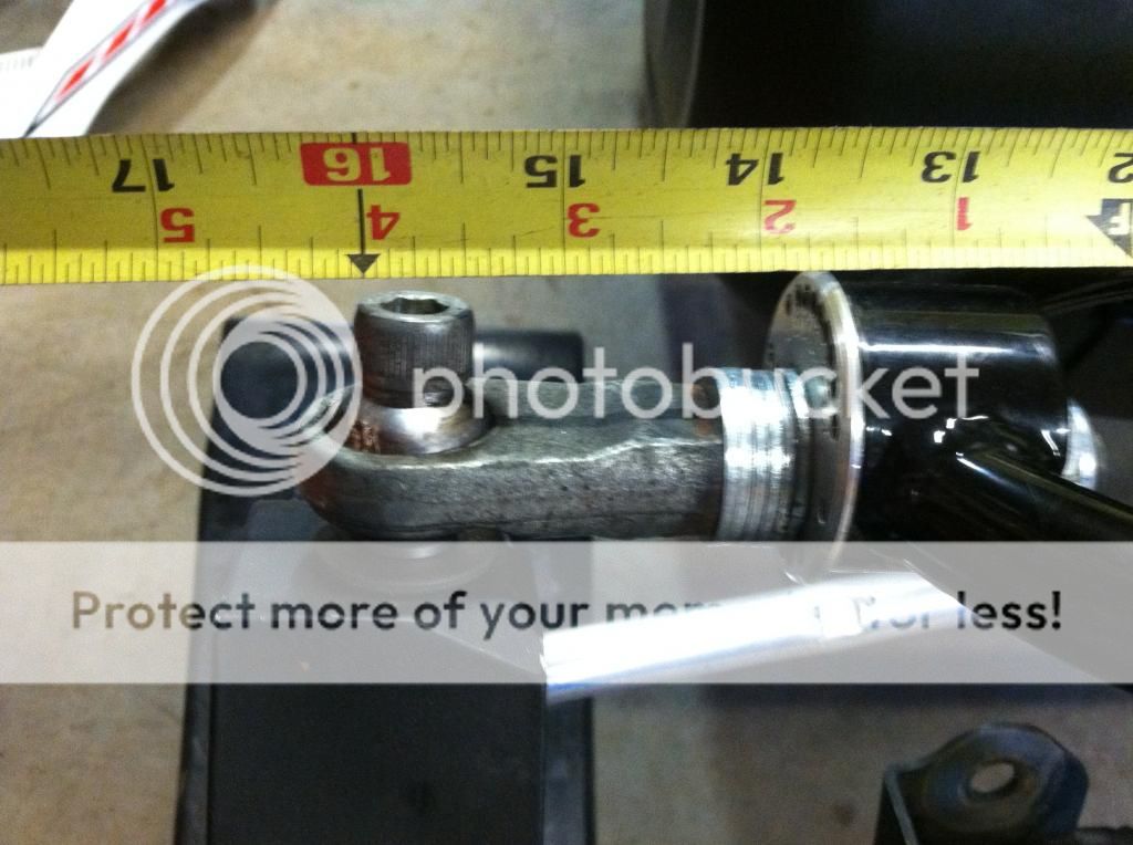

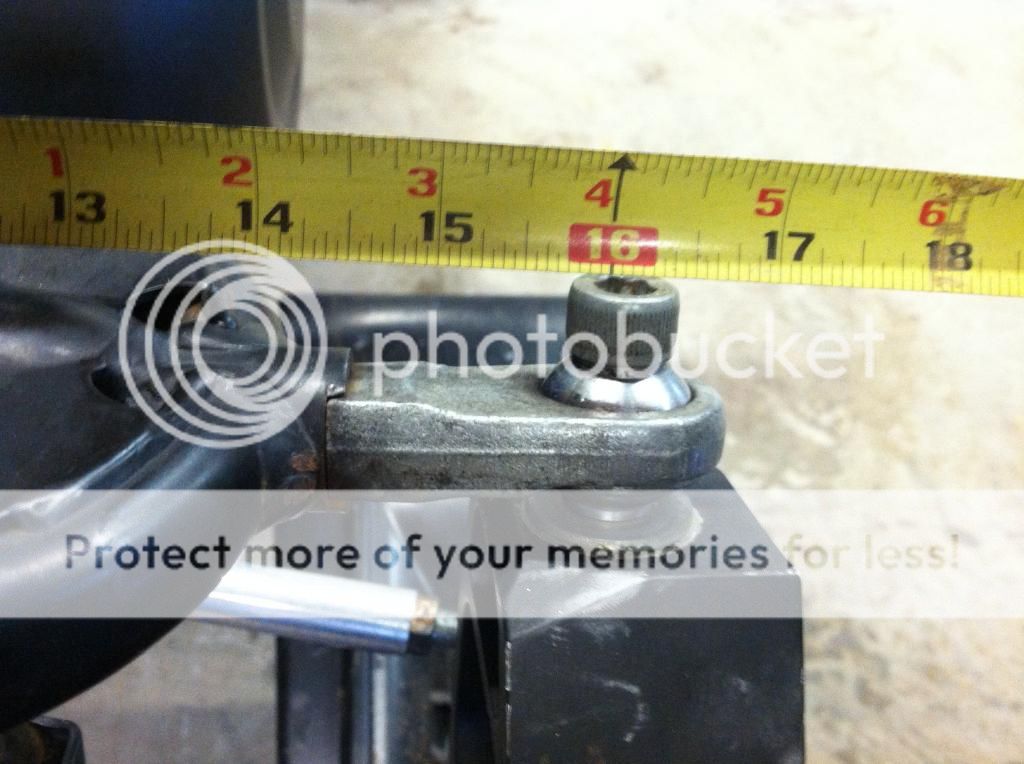

I will be calling them to get more information but so far I'm not liking these arms. I bought them more for the caster adjustment and I could careless about the camber adjustment because I can adjust that by taking material off of the ball joint. 1/4" shorter than stock means I'm stuck with several degrees of negative camber that I really didn't want. I also contacted them two weeks ago because the grease fitting positioning makes them difficult to grease and I already have loose bushing with less than 100 miles. They said they know about the fitting and they'd send out new bushings but I'm still waiting on the bushings.
Stock a-arm measurement
Slicast a-arm measurement

I see what you mean. It looks like a 5/16" difference even with the 6 spacers.
Pete
Pete
Interesting, I ordered a set of these arms when they first came out ( for a 2008), and I only got 8 spacers. Makes me think my setup must be WAY off .
