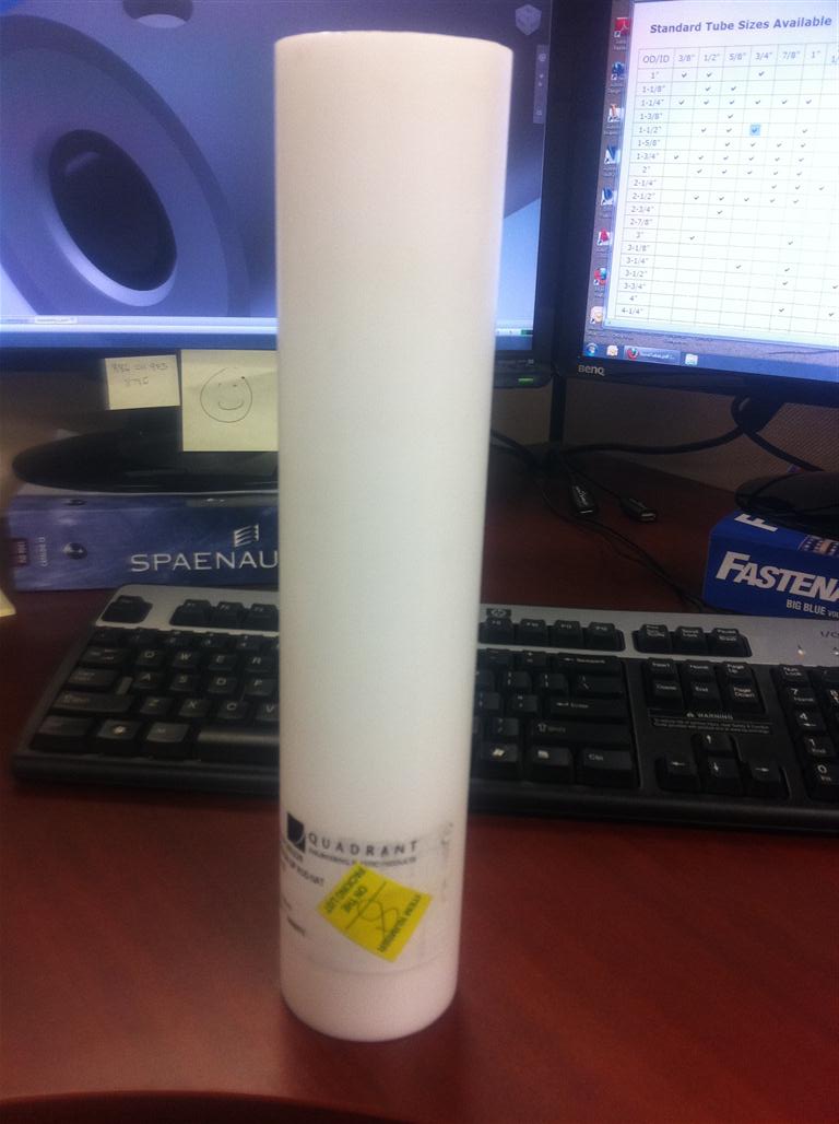

So I went ahead and decided to machine my own spacers to save some money. It was a simple engineering calc to figure out how much the torsion springs compress, and the clearance between the spring and spacer required...
Material cost me 25 bucks from McMaster, and took a hour or so to machine up. If anyone is interested in doing this, PM me and I can give you the CAD ;)!
Here was my design (not sure if its the same as hygears) but should work well. I don't have my skid back in, so im not sure if it fixed my sag yet...hope so!

Is that teflon?
What's the inner and outer diameter?

It's all fine if you have your own lathe, but the cost of the material and the price of a machine shop lobour hourly, would cost more than the price of the Hygears.
Oh for sure, in the long run I likely only saved 20 bucks, but it kept me busy for a few hours on a rainy night!
