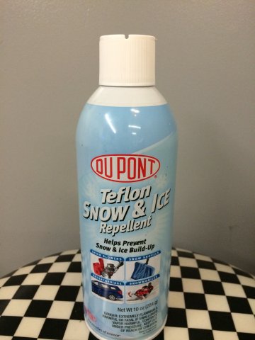

You mean Catamaha, like my bud says if you put a Cummins in a Dodge its still a Dodge! But hey you should have bought the Catamaha cause in all my years of riding Cat they where quick to recall unlike Yamaha. I sometimes think this has led to some who claim Yamaha is perfect because of no recalls. I know better! No sled is perfect!
As far as the Nytro went I guess you should have read here first or bought an Apex XTX, no problem with ice buildup with mine but like my buddy I carry a plastic hammer to knock out ice in the morning. Nature of the under seat exhaust but wait I used to knock out ice from under my Cat as well because of those tunnel coolers.
I have had to knock the ice out of tunnels on air cooled sleds as well. Only thing that helped a bit was spraying Pam or cooking oil on the tunnel. It would take longer to ice up but it still would.
I am experimenting with spray dielectric grease trying to prevent the front door on my Floe Protektor from freezing down. It actually seems to be working which is a bit surprising considering I did not get everything thawed and dry before spraying.

With regards to the ice build up discussion. I used this on my snow blower and it worked well in some wet sticky snow.
I think that spraying this in your tunnel would help reduce the ice accumulation.

Xs 2 using the Dupont Teflon, it does work, not for the full season but it does work for awhile, then reapply. Used on my 09 Nytro RTX.With regards to the ice build up discussion. I used this on my snow blower and it worked well in some wet sticky snow.
Happy New Year! Let's hope that 2-15 brings us some much needed snow!
Will that stuff work on drop doors on trailers??? sometimes mine freeze and it would be nice to have something to coat it with so it opens easier when water gets on the seals and freezes.
I don't see why not. It is certainly worth a try. I bought my can at Menards but I would think that you can find it at at Home Depot, Lowe's, Walmart, etc. I don't remember exactly what I paid but it wasn't that expensive. I will try it on my sled if I ever get enough snow to need it!
