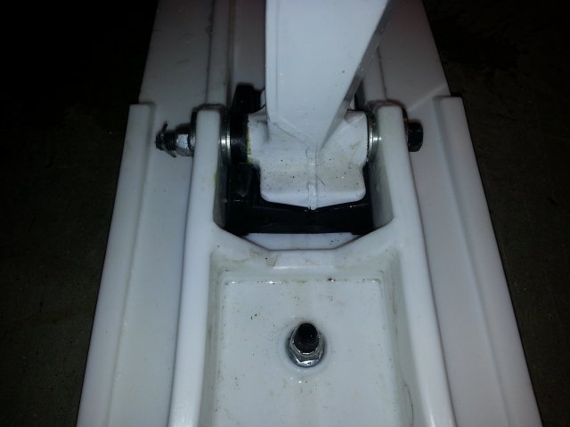

Here is a few close up pictures, Not sure if this will help or not.
The picture of the orange ski shows the slydog rubber, I think its kinda wimpy compared to the OEM rubber that come on the Turner Ski.

Subaru2006 let me re-phrase when I said they fit "ok" . They fit perfect, no mods, no fuss, fits like its a OEM part on the SE model that came with Turner skis.
The LE model came with mountain skis so I did use the slydog rubber from the kit. If I was to order them again I would not even ordered a kit for the LE model because all that's needed is to cut off the nubs with the razor blade on the OEM rubber and it would fit perfect, With the nubs on the bottom its 3/8 inch to tall. Once there cut off the rubber looks just like what comes with the Turner ski. I will still switch back to the factory rubbers next time I have the skies off and cut those nubs off.
