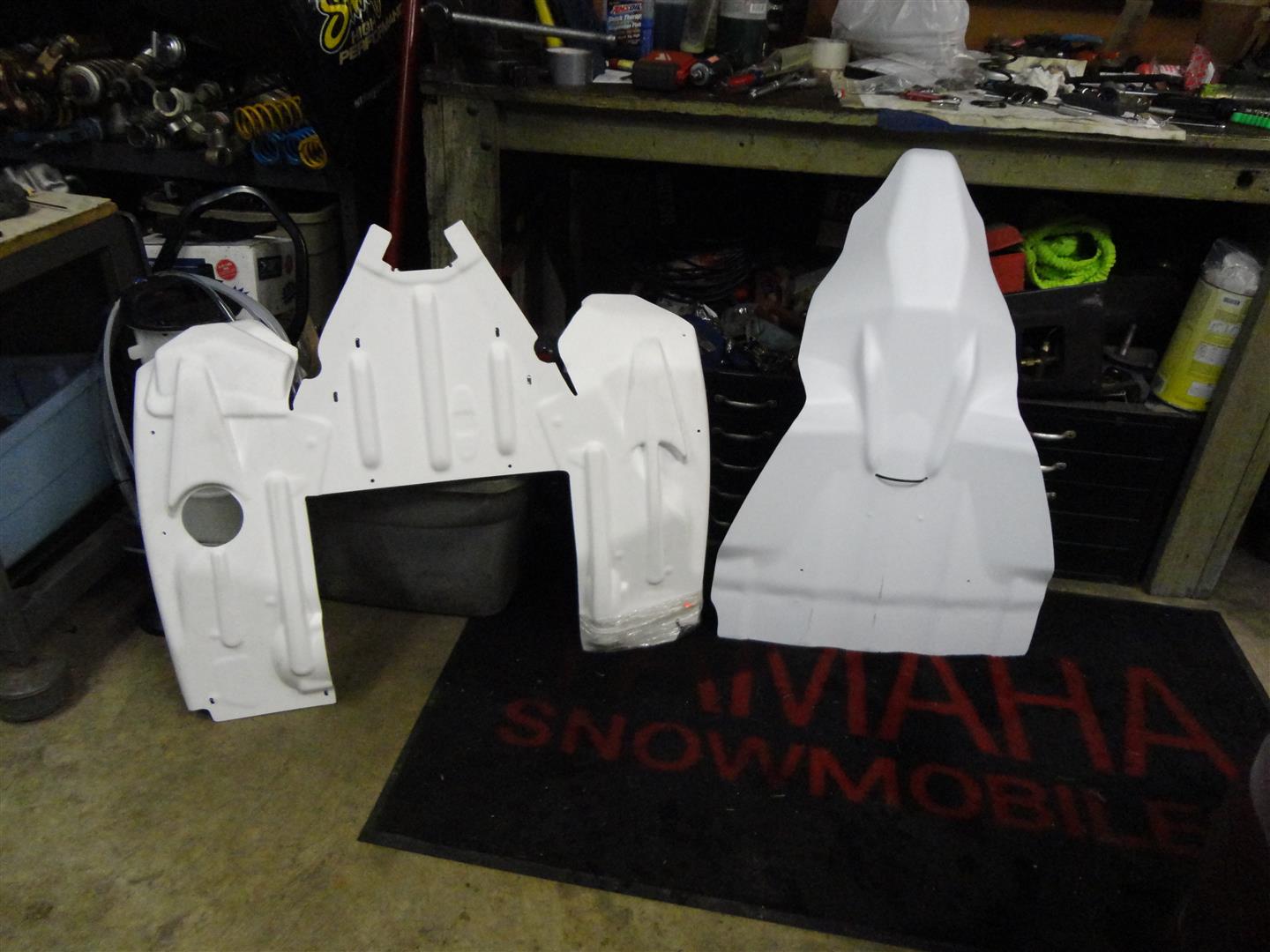

I am using a Cat white one AND a Skinz float plate. I know I will have to remove the Float plate but hopefully not the AC one. Suspect will be some work involved for sure but the AC skid really fits nice and tight and I need something for the sides since stump damage reared its ugly head already. Does Yamaha one look like this one on left?
