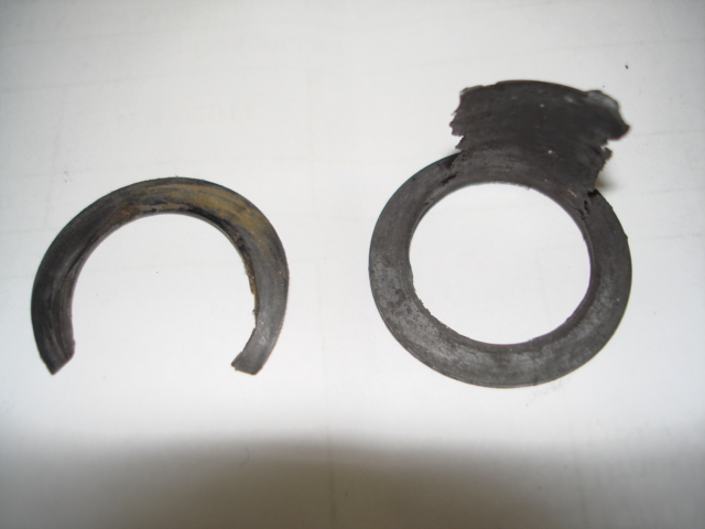

I put Ulmer's oilite bushings on one side of my sled tonight. I will tackle the other side tomorrow. The ski spindle shaft was a tight fit and was difficult to turn by hand after installing the oilite bushings. However after pumping the housing full of grease and working the shaft back and forth the shaft began to spin more freely.
I was surprised to find that the OEM plastic bushings in the spindle (the two for the shaft and the four for the A arm attachment points) were all in excellent condition and really did not need replacement.
The bulkhead and A arm OEM plastic bushings however were completely shot to the point of being nonexistent in a few locations. The oilites really helped to tighten up this area which was very loose with the worn out OEM bushings.
