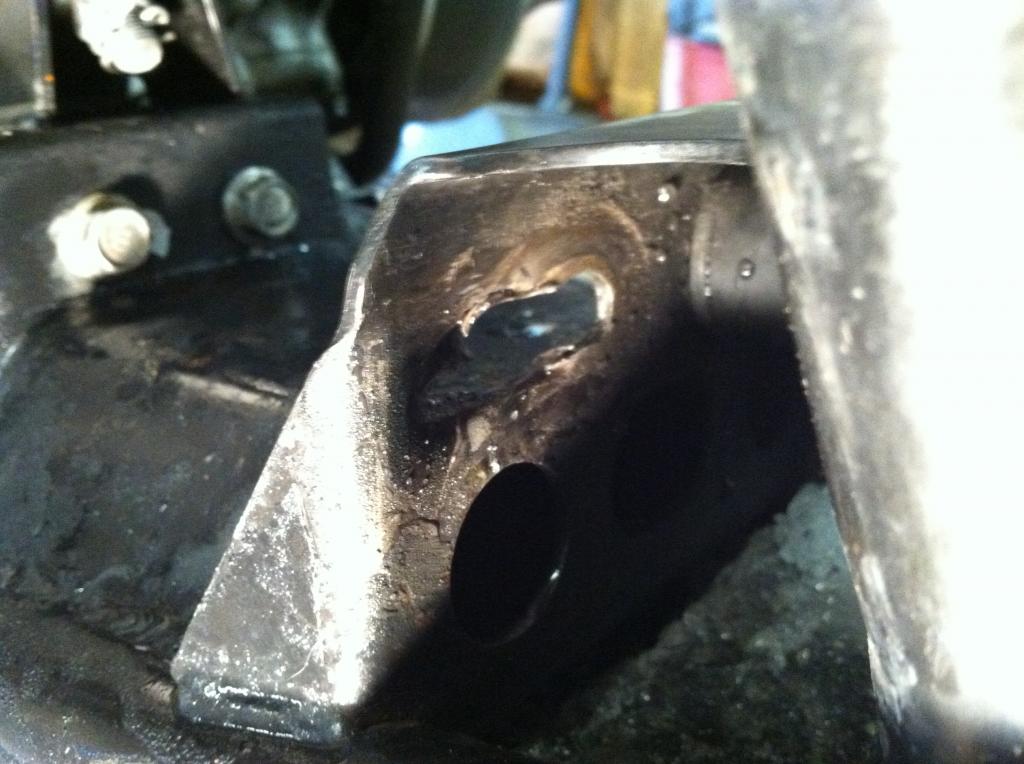

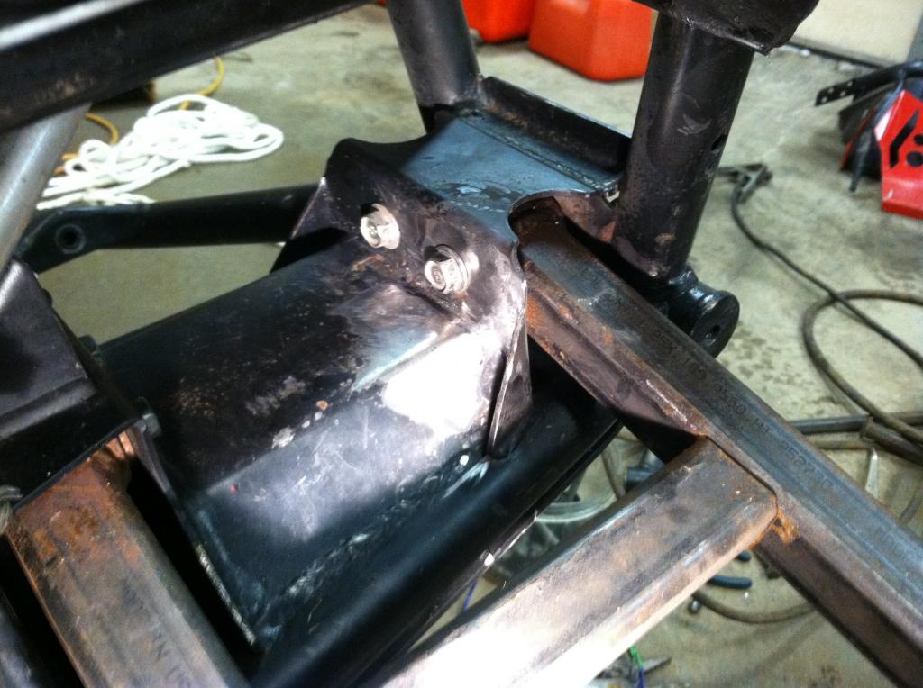

I ripped the a-arms off on a rail crossing and the frame survived. I did have to repair one of the lower a-arm mounting holes but other than that the reinforced frame held up to the impact.

The front lower a-arm mounting hole was torn pretty bad but It was the only subframe damage and that was repairable. Peter at Mountaintech called me minutes after I did this to discuss running prototype trail arms so when I put it back together I did some testing with the Mountaintech arms.

Wow Grizz, that is crazy? Super impressive how your reinforcements held up. I am running them on my 08' and felt the sub frame would be pretty stout after welding them in. G.B.The front lower a-arm mounting hole was torn pretty bad but It was the only subframe damage and that was repairable. Peter at Mountaintech called me minutes after I did this to discuss running prototype trail arms so when I put it back together I did some testing with the Mountaintech arms.
