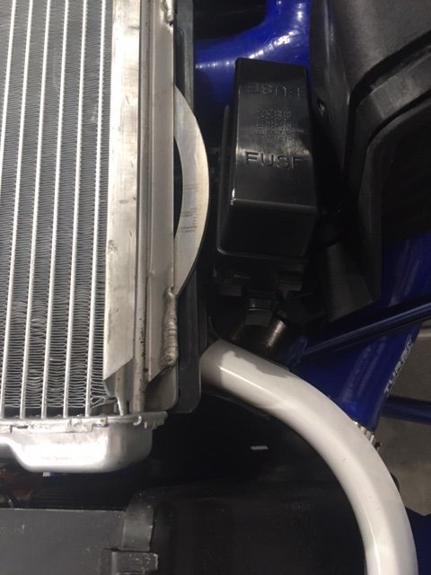

You have dealt with a 2nd (or maybe 1st?) source of excess heat in the tuned 998. The stock cooling system is engineered for stock HP output plus some safety factor. Once one increases HP output by 25-50%, it can no longer shed enough of the added thermal load and the coolant temp starts to climb. I mean at big throttle openings. No matter how much IC one has, coolant temps will still climb, at some point getting to unsafe levels that greatly promote deto and engine damage. The head will overheat. Watch your coolant temps during a WOT episode.That definitely is a challenge with the rad kit. The stock fuse block wiring harness does not allow a lot of wiggle room and space is very limited to locate the fuse box. Mine is turned sideways and mounted along side of the rad which is a compromise for sure. If I ever get motivated enough I may build an extended wiring harness and completely relocate the fuse box.

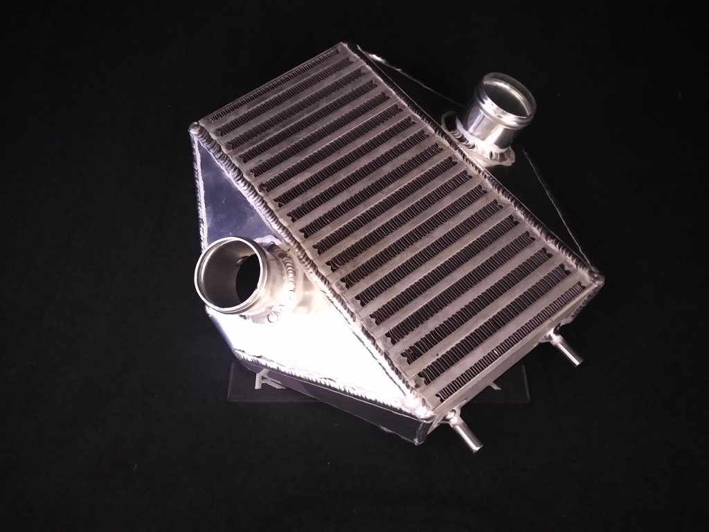

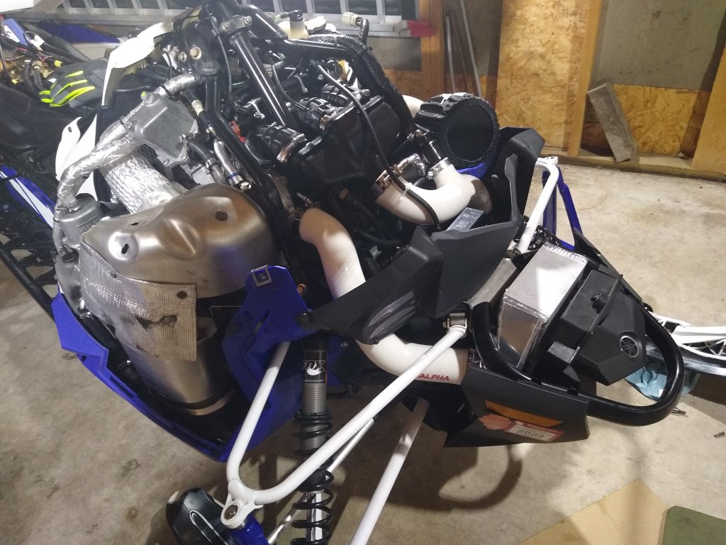

Completed thursday....Happy trails.
Looks great...whose cooler?
He's a funny guy, him and I got along pretty good. Spent some time with him the other day.I tried to get him to make one for me a couple years ago.
He's on the fence to build headers. He was bobbin and weaving while we danced around the ring. Lol.
Bob..... Google Vinnyfab.
All I can say is the fit was 100% dead on.

So does the plastic around that cooler need to be modified? Seems like all the other options do except the PEFI oneCompleted thursday....Happy trails.
View attachment 174475View attachment 174476View attachment 174477

No, trim work. It's what we like to call " plug & play"So does the plastic around that cooler need to be modified? Seems like all the other options do except the PEFI one
It can be swapped out in less than an hour, providing you don't drop a bumper bolt down into the bumper. My bad.
He had enough material to build two, maybe three more, from what I saw.
So, you can have it by Jan. (That's up to him, not me)
