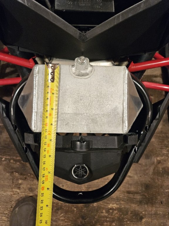

I stand corrected. Turbor big intercooler is 4.5".

Nice! Look at you snatching up the opportunity to brag up 4.5” hahaI stand corrected. Turbor big intercooler is 4.5".View attachment 174743

Yes, justin. Perhaps he is making fun of my little 3"er? Hahaha..Nice! Look at you snatching up the opportunity to brag up 4.5” haha
It this case, size does matter. I probably shouldn't have passed on that super cooler for $500. Oh well.
Looking at things, I'm surprised they got that to fit, must be tight.
Yes, but not a lot of room behind it to get the air out from behind it perhaps? Might negate part of the gains of the added girth.... LOL!

DMC, does that intercooler taper down towards the bottom, or does it maintain its girth?I stand corrected. Turbor big intercooler is 4.5".View attachment 174743
Front mounts are without a doubt the best you can get, for obvious reasons.
That my friend, could very well be the most effective & efficient front mount available.

Maintains its girth.DMC, does that intercooler taper down towards the bottom, or does it maintain its girth?

Very nice....that fat daddy is bada$$. And worth the price of admission.Maintains its girth.
I would like to see ambient temps during a 1200ft pull on MS20 vs the 3" I have.
Just my opinion, but that intercooler is a very good compromise.
That's for sharing...

Temps are down 20-25 degrees in 1320'.Very nice....that fat daddy is bada$$. And worth the price of admission.

Do the temps stay down after running across the lake?Temps are down 20-25 degrees in 1320'.

I've only compared on datalogs over a 1320' run. It would be 20-25 degrees less than the stock cooler over all scenarios I would bet.Do the temps stay down after running across the lake?
About the same with the 3" VinnyFab then. I've always said about the same, 20 Degrees over the stock cooler. More if its colder out.
