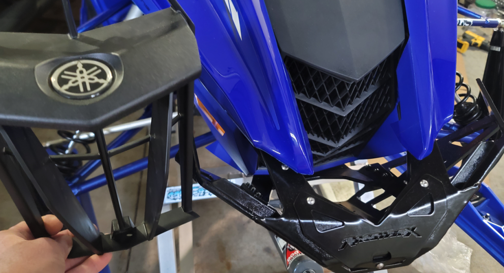

Good feedback on the frogskinz Mike. Was curious if that kit would work.
100% agree on the snow - as others have done, I just installed the Arctic cat grill (part #: 7606-117) - hoping it does a better job than the stocker. Quick pic for comparisons.
I run the Cat grill on my Winders too, it works much better than the Yamaha grill, does't hold near as much snow. Want even better cooling and airflow take the grill right off, it helps to cool better also, but of course you're risking damage to the cooler, so I run the Cat grill all the time.
I want you to know I did not put the frogskinz in front of the intercooler, but behind it on the huge hole after ventilating the bulkhead. Putting It in front of the cooler would absolutely kill the flow of air to the intercooler, this I know.
