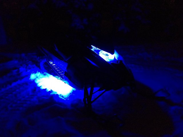

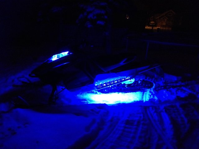

After seeing "dylanjen9"'s sled lit up in his avatar I decided to put lites on both of my Vectors. Dylan was awesome...he sent me pictures of where the lights were mounted and how. Found a place on eBay that sells the lites I wanted (there are so many variations!) as well as a remote on/off FOB that I have on my key ring. I have nine LED pods on each sled. I think I did each sled for about $65 including the remote. You can get light controllers that will make the lites do more things = more $$. I'm happy with on and off.
PM me if you'd like more details.

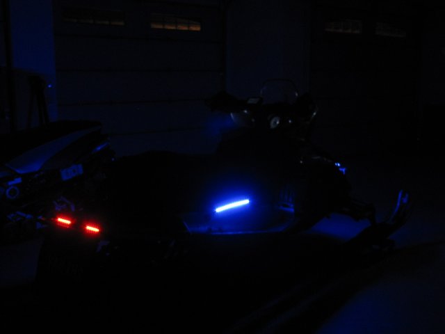

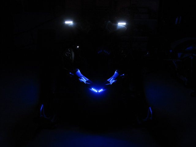

Not really. I took my time and thot where and how to run the wiring and place the light strips. I ran the wires where it could encounter ice in steel brake line tubing and the other areas like under the plastics I ran it in clear tubing or wire loom.These are cool. Is it hard? Looks great!
Solder connections everywhere with heat shrink. A few strain reliefs and clamps to keep the wires and lights from moving or getting torn off. Placed the switch where I could use it while riding and was good to go.
