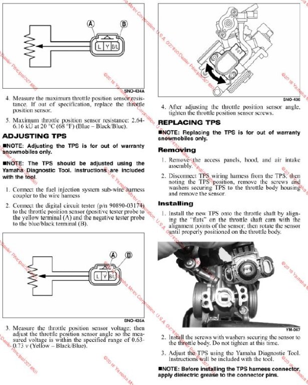

Is there a way to test TPS voltage? I can't find my service manual atmYou have to post vids on YouTube or Facebook and link them. Whats the AFR say before it dies. Is it 9? Could be loading up. If it won’t run at idle without throttle then it could be the map sensor.

I’d have to look in the manual for the volt number and procedure. Maybe someone else will chime in. @SrxspecIs there a way to test TPS voltage? I can't find my service manual atm
