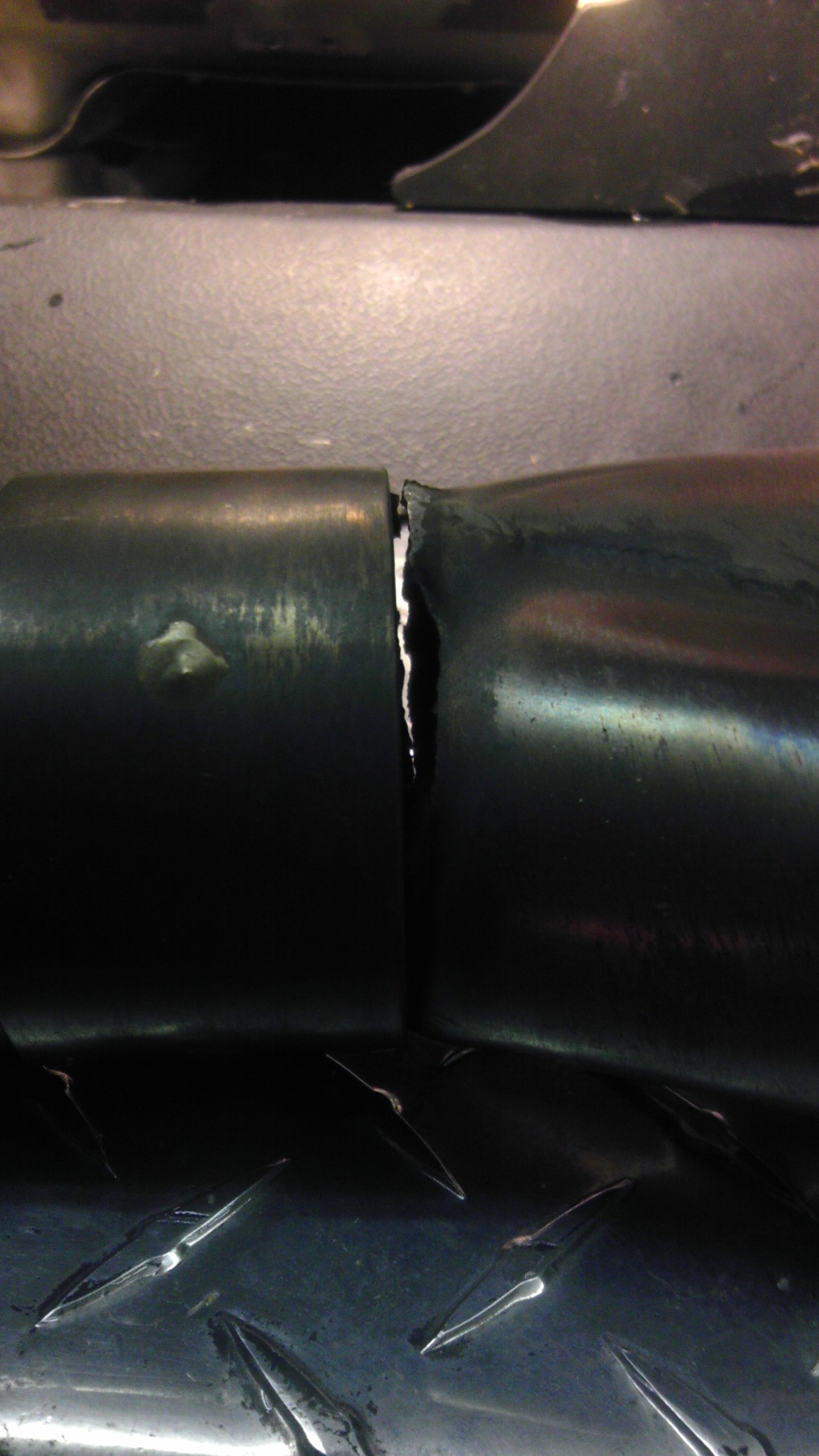

Ok, dropped the suspension & this is what I found, the pipe that joins the "Y" pipes together, the last pipe before the exhaust pipe, has a crack where it joins the two pipes together, probably cracked 3/4 the way around. Being that far back from where the exhaust exits the motor, would that actually cause me to loose the 500 rpm's?
Also, it is a Excell exhaust, what material is it made of, can it be welded?

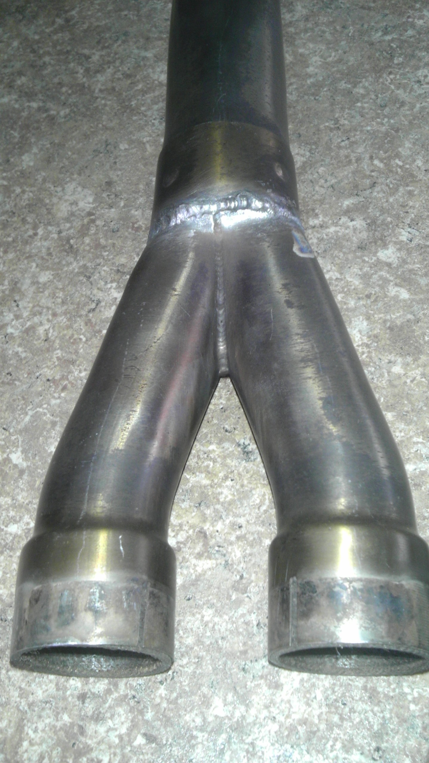

Ok, all welded up & ready to put back in!! Hopefully this cures my loss of RPM issue!!!!
Put the sled back together & went for good ride today. The cracked pipe was definitely the reason for the loss of RPM's, gained 700rpm's with the crackless pipe, wuhooooo :Rockon:
Didn't think a crack that far back would have that much impact on rpm's, hmph, guess I was wrong, lol!
