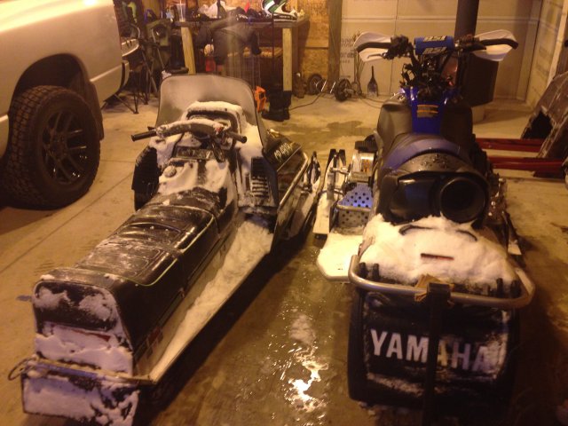

Yep.
Wife's XTX has about 2" curve in it, she has a Lake Effect pivot bar riser with readjusted angle to suit her.
We also swapped seats this past weekend, improved ergos with the WRP.
