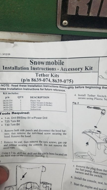

Part number for magnetic tether? Can find regular one not the magnetic.

8639-075 for 4 stroke machines; you need the "normally closed" version. Should be about $60. US.Part number for magnetic tether? Can find regular one not the magnetic.
Looks like you may have been looking for this part number for a while; when doing a search, I saw your request for the part number in several threads.SideHogger

Thanks for info. Appreciated.8639-075 for 4 stroke machines; you need the "normally closed" version. Should be about $60. US.View attachment 165192View attachment 165193Looks like you may have been looking for this part number for a while; when doing a search, I saw your request for the part number in several threads.
