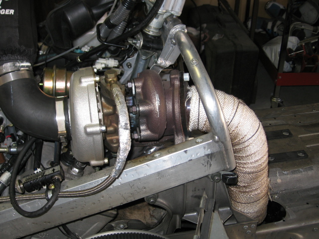

The special parts your supplied were just what I needed to complete this project.
3K large turbo onto a unique header, straight exhaust I made directly off the turbo, Platic welded tank to 31 litres, right side intercooler for direct charge tube off turbo, mapping for large boost. and a beautifull Mountain Mod seat with huge trunk.
Working on the mapping now as turbo placement has a huge effect on mapping difference compared to the same mapping on my rear mount. A lot leaner from what I am finding. It is rideable and able to run to 15 now with the same clutching I had on the rear mount to 17 lbs. So I think we are making progress. Will develop it more over the sumer with a complete chasis, skid,paint work, and internals in the motor.

The reason I wanted something like this.........the weight off the back of the sled for climbing nasty crap........but the heat, small tank and header issues are annoying.
A few pics attached of the sled.......and a couple from TS5 courtesy www.bigskyx.com

Randy, would that turbo be equal to a gt28rs or is it bigger.

Ya when i saw those pics on Snowest i knew you had something going.Thought it might have been just the Mcx intercooler on a different kit.So is this kit going to be available to all or is it totally custom?

givemeaboost said:Randy, would that turbo be equal to a gt28rs or is it bigger.
Not totally sure...........but it will push 26lbs.

WhistlerCowboy said:Ya when i saw those pics on Snowest i knew you had something going.Thought it might have been just the Mcx intercooler on a different kit.So is this kit going to be available to all or is it totally custom?
Erik has little interest in building the complete kit as it takes away from the huge production he has on standard kits. Headers and fuel tanks are a PIA to build.
I suppose it could be built as parts only and make some yourself......that is basically what I did..........and the develpoment has taken lots of time to figure out especially the mapping!!!
I have had the sled completely apart more in the past few weeks than any other 4 stroke sled ever..........now I know what all these Turbo builders go through developing their own kits.......kudos to them
