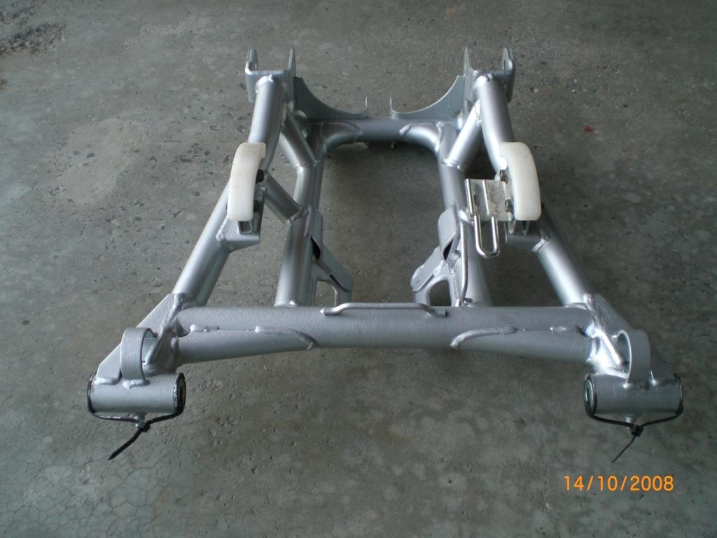

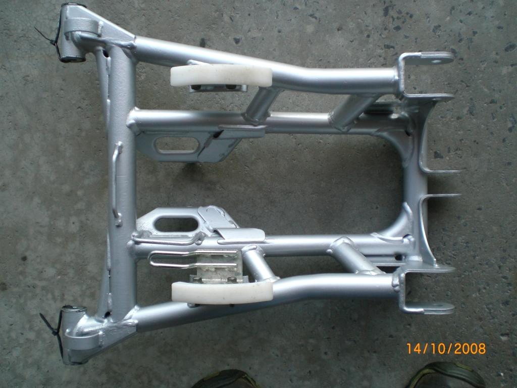

Part #8FT-47331-01-00 ('08-'09) is the BEEFED-UP 1 you want to order, Port Yamaha has it for $335.00 and the non beefed up ('06-'07) part #8FT-47331-00-00 is $309.00
Yes the OEM is a bit stronger than a re-built, OEM have a bigger upper cross tube and the bracing is a bit better but the price is STEEPER...here's a pic of my '08
JERSEYJOE said:Does Yamaha supersede the 06 part number to the new part number? If it is a better direct bolt in you would think they would. Not sure if the dealer will install something from the " wrong " year.
Is the 08-09 arm as good as the aftermarket built up ones?

redrx1rkt said:I ended up putting in a 2010 upgraded W-arm. There's a huge difference in the strength of the 2010 part vs. our 2006 parts.
To my knoledge the '10 will NOT fit the old style MONO suspension due to '10 having the new needle bearings on lower rail mounts (different rail profile) which '09 or older don't have...

apltx08 - the one you have pics of is exactly the one that's in my sled now. I was told it was a 2010, but I guess it's a 2009.
apltx08
redrx1rkt said:apltx08 - the one you have pics of is exactly the one that's in my sled now. I was told it was a 2010, but I guess it's a 2009.
I've noticed that the '10 has a tottaly different part # maybe it does fit but I haven't tried fitting 1 myself on the old style MONO yet.
