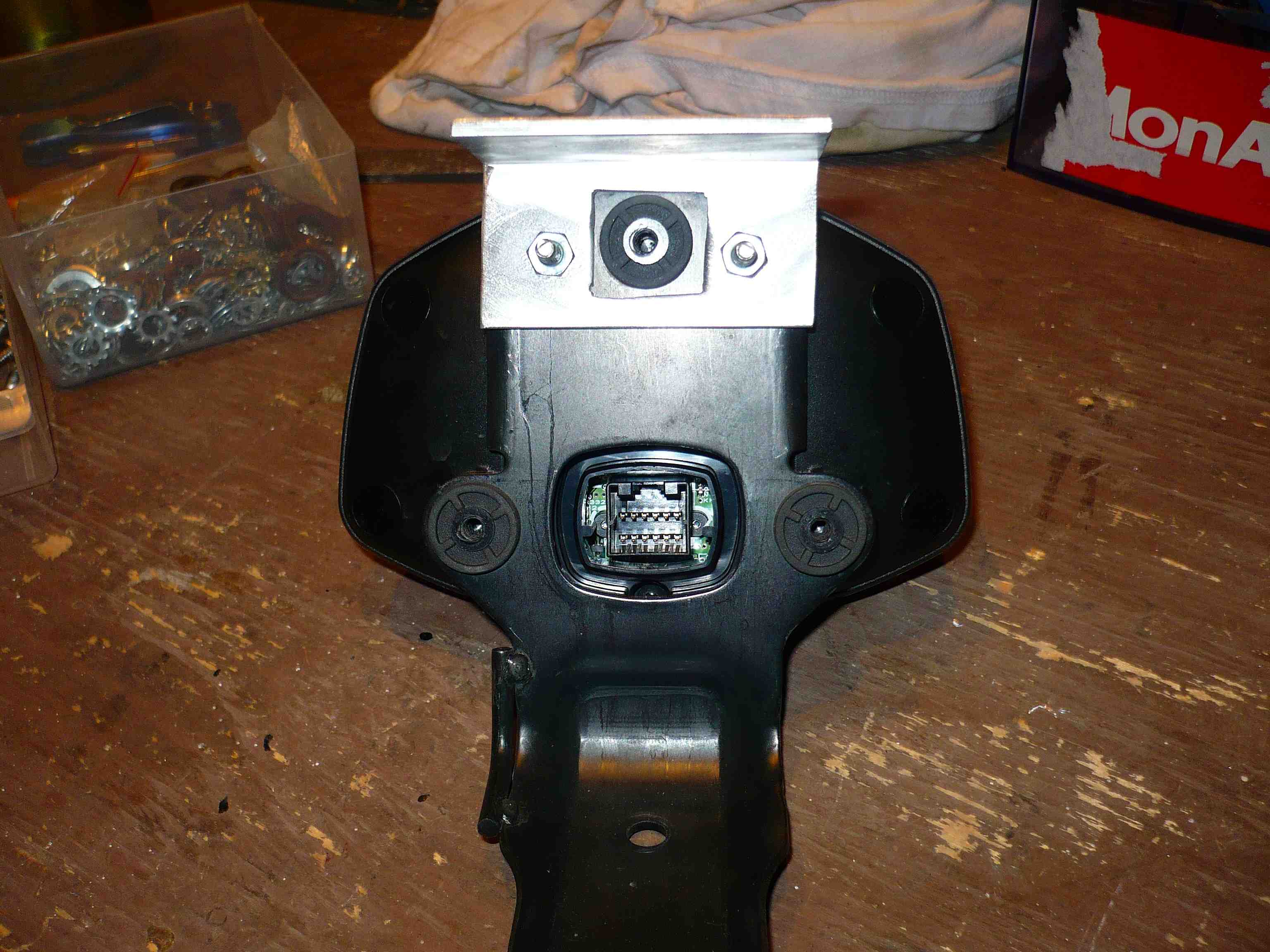

I made a small bracket that mounts to the back of the speedo bracket to mount a water temperature gauge.
I cut a 3" piece of 1.5" x 1.5" angle aluminum and mounted that to the back of the speedo bracket with 2 bolts. I had to cut out the center to clear the rubber grommet for the speedo. I then painted it black and mounted the gauge pod to the top of the angle iron.
I made it large enough to mount another gauge if needed.

Looks good. Hopefully it's not so heavy to make the stock pod bounce up and down too much.
I was worried about that but the gauge and bracket are pretty light. If it does bounce too much I will weld up a support to the speedo bracket.
Cool idea, and good job on the fab work. My opinion is that the stock pod already sits up pretty high. what about a roll over? would hate to see it ripped off the sled after all the effort.
With the stock medium windshield I'm not worried about a rollover. But I want to change to a lower windshield and then I need to think of a way of protecting the gauge. If it becomes a problem I will mount it on inside of the riser.
