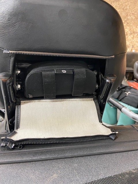

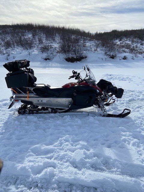

Ice scratchers installed. Hard to see but there is plenty of clearance when up from the boogie. Also got a weatherproof eye glass case for my extra relay, plugs and sockets.
Now will a YTX20H-BS YUASA fit in a Venture MP?

sailor joe
- Apr 4, 2019
- 761
- 622
- 778
- ma
- 2016 RS VENTURE TF
2020 SIDEWINDER GT
great photo!! is that a gas grill on top? JoeReally enjoying the ride for ice fishing. It seems top heavy!
