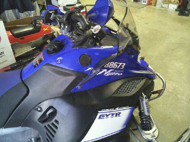

Shaddow... Here are those vent location photos I promised. Note the ram air opening below the headlight it directs air right onto the air box lid.

shaddow44 said:Sweet....what size were those slp vents again ..2.5" and are they the snap in ones or the ones that use the rubber ring on the back?
Yes, SLP the plastic ones 14-197 they say good with 2.5" hole saw.
But the rubber ones would work nice too i bet.
I popped off the chrome emblems and cut dead center.
Gooped up the inside edge with sealent.
Good spot behind the rad... I've even rode with my left glove off and can feel the heat pouring out.
