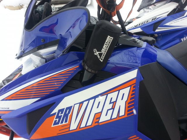

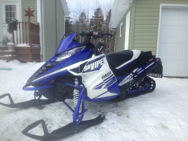

There are a couple ways to mount through the hood. I removed the grill in the side pannel. John @mpi said he liked to go straight through the hood. The first two pics are my sled and the last is one John sent me. I like both. Hard decision.

Did you remove the foam cartridge from the filter?There are a couple ways to mount through the hood. I removed the grill in the side pannel. John @mpi said he liked to go straight through the hood. The first two pics are my sled and the last is one John sent me. I like both. Hard decision.
I ran with the side cowling off and only saw 100-200 rpm more? I did take the clutch air diverter off and it seemed to work as good. Just not ready to put it threw yet.
