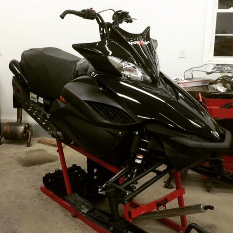

Bought a 2007 apex gt with 1600 miles on it this past spring from guy around here for $3800. Bought it for her daughter so was never beat. Not yet anyway. Took it apart because needed exhaust gaskets, come to find out yamaha didn't tighten the bolts that hold the y pipes which caused the gaskets to go so early. While I was doing all the work I thougjt I need to do something to make this sled look different. So I decided... A blackout... Not quite finished yet but a few parts bought from a totallyamahaer Iv almost got my finished product

I'll add in the new parts I have on it. Higher apex mtn riser, rox pivot riser, wrp seat, HID's, black bogie wheels, and hopefully soon to be orange led accent kits all the way around

Looks real good!

nice looking sled

Nice sled, bigger pictures if you can any stickers going on it?
