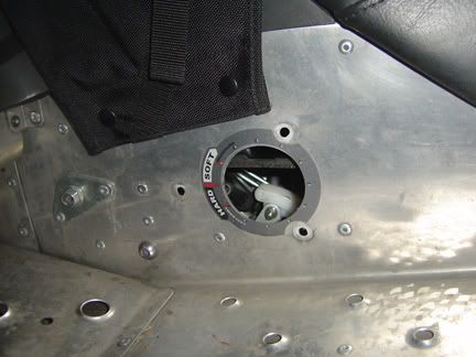

RA Adjuster went - holes are ovaled out.

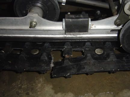

Track got ripped up

Track got ripped up

- The RA adjuster looks like it loosened off somehow. The oval holes in the tunnel suggest that the bolts didn't come out quickly. Once the screws fell out....

Looks like the front arm broke first which loosened up the track just enough for it start rubbin against the RA adjuster (small chunks were taking out all along the left side of the track right where it would rub against it. Amazingly it got those screws loose and out (or sheared very quickly). I came up off a small crest just barely got the whole sled off the ground and that is when the loud noise came. Got off the sled and noticed the carnage. Went back to look for the RA but couldn;t find it anywhere - must have got throw to the side in some deeper snow.
