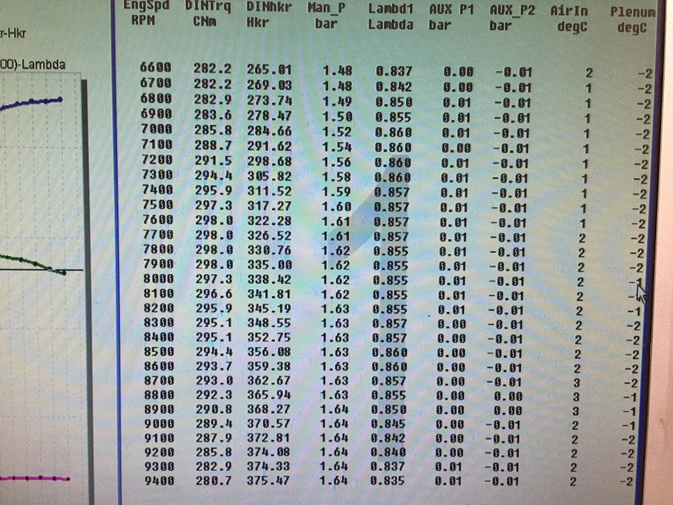

Run the last mount of the seson last winter with this amount of boost on pump gas and it realy riped.
We fined tuned it now in the dyno and this SideWinder engine i must say is super great and this turbo kitt made from
https://www.facebook.com/MM-racing-698447116999977/?fref=ts is realy loving this engine
