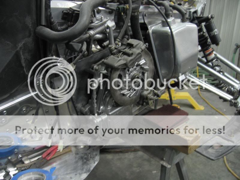

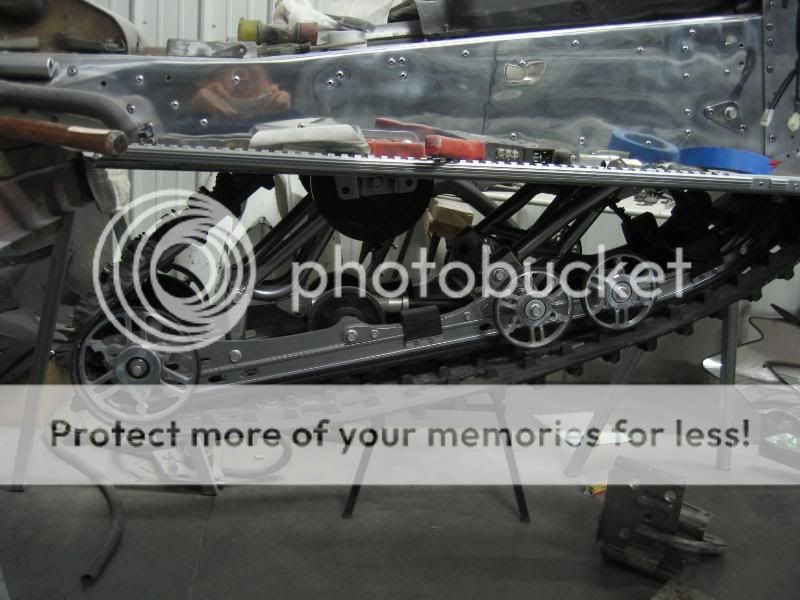

A few progress pics:
welterracer
Thats gonna look sick when its all done..
Those chrome spindles look great..

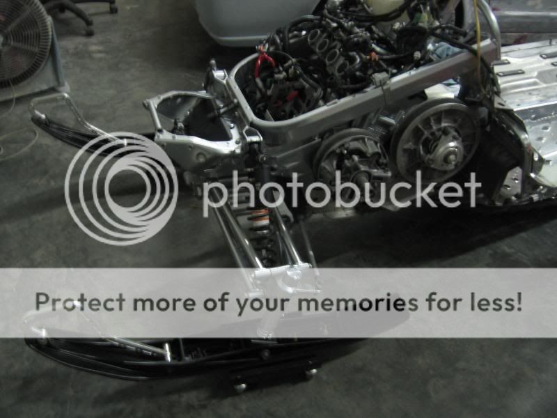

A few updates..Its at least back on the ground now. We tried to fire it up Sunday night, but found the starter relay was corroded and wont send power to the rest of the sled, so....
We couldn't work on the sled today, so we screwed around and flamed the golf cart!
