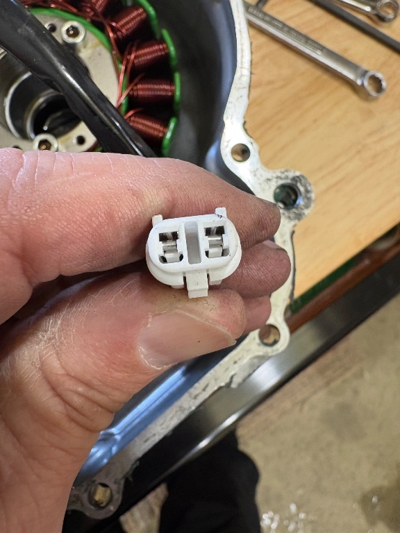

use a small pick tool to pry up and release the plastic tabs that lock the terminals into the plastic hard shell connector , then you can pull the terminal out the back

There are also a tool called "pin keys" can buy off amazon or a local parts store maybe harbor frieght, but as turbo flash says a small pick and patience will getter done.

My bad...i ment yamahon1 not turbo flash.There are also a tool called "pin keys" can buy off amazon or a local parts store maybe harbor frieght, but as turbo flash says a small pick and patience will getter done.
rlbock
Thanks got them switched, thanks for everyone’s helpMy bad...i ment yamahon1 not turbo flash.
