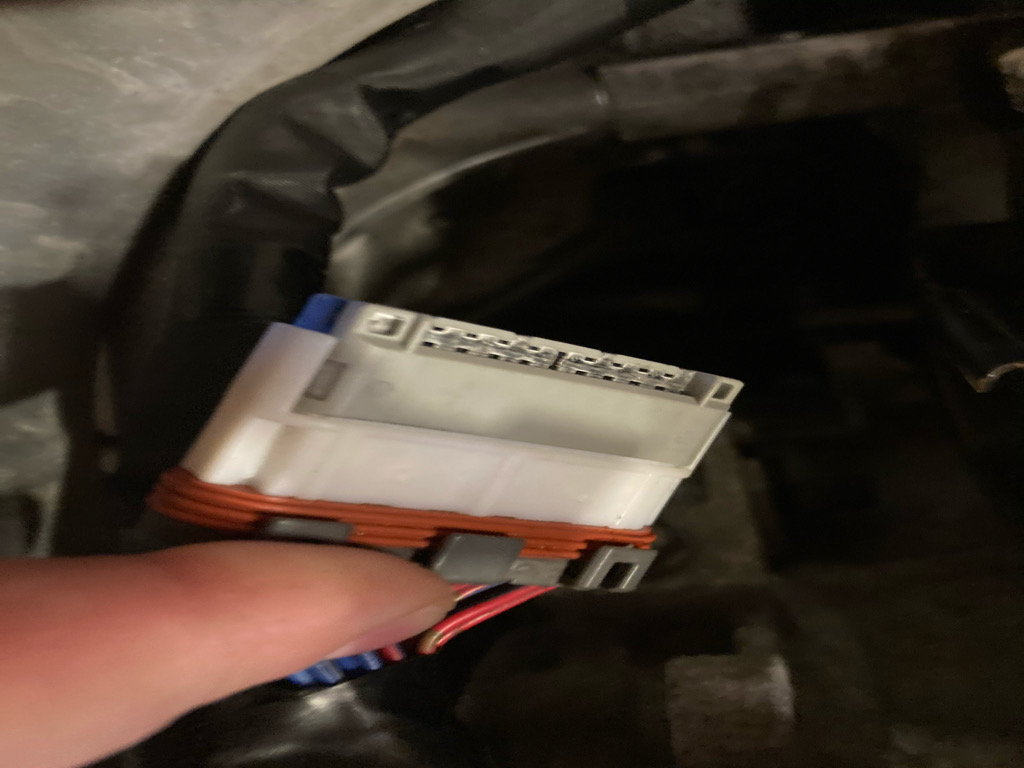

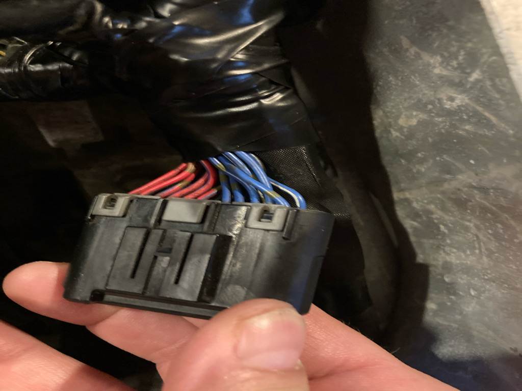

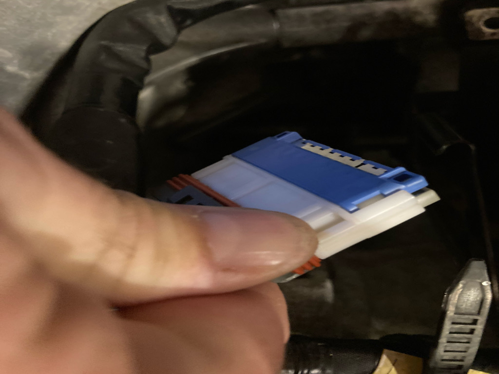

So..a little more trouble shooting. STARTER RELAY: Got 12v on the red with white wire with key on, and blue with white goes to ground when starter is cranked. Between 7 and 8v on the red with green wire, and the longer you leave the probes on the more it continues to drop... FUEL PUMP RELAY: same thing on the red with green, 12v on the red with white, 12v on the blue with red, and nothing on the red with blue.. If i jump the red with white over to the red with blue the pump powers up and runs continuously, and sled starts...but i know thats not the way its supposed to work!! Still no voltage at the fuel pump on the red with blue either, which is my main concern. Traced the hot wire from the fuel pump through the harness and it ends in a "terminal block" with a bunch of red wires and blue wires, near the primary clutch. (As shown in pics, cover off left, cover off right, cover on) Popped the cover off that and it looks fine.... Should also mention that with clip of test light on positive bat terminal, light comes on when touching ground wire at fuel pump, so that leads me to believe that it is not a grounding issue. Also checked the grounding blocks throughout the harness for corrosion and found none.....This is driving me mad... someone please help!

So my vector went to the shop...turns out it was the starter relay, which i did repalce, but it was with a cheap amazon replacement part. The key is to have two 12v wires from the starter relay to the fuel pump relay, one for magnetizing the coil in the relay and one to continue through the relay...i only had one 12v and one 7-8v...corrosion in the relay was causing voltage drop. When ever possible, buy genuine replacement parts-lesson learned.
