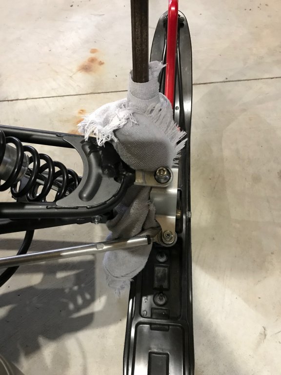

I straightened my 08' subframe with a 3' pry bar and welded in Grizztrax reinforcement kit. It came out awesome! G.B.
View attachment 165740you straighten it then took the sub frame out and got it welded ?

Yes, easiest way to straighten the sub frame is with the sled complete and sitting on the floor, but with all the side panels removed. This way you can use the bolts that mount the subframe to the bulkhead as a fixed point on either side to take your measurements to the A arms. The actual dimensions are not as critical as having the dimension the same on the right and left side. Then I removed the sub frame and stripped it completely down so I could weld in Grizztracks 3 reinforcement plates. I also had to weld up the steering inner tie rods pivot flange on the subframe that was egged out. I then had the subframe powder coated so it looks killer and will last forever. GB
