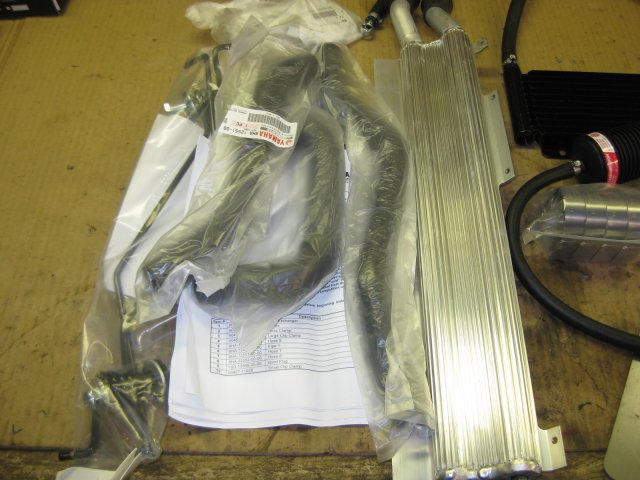

What is the specs on belt or make of belt I need a replacement but can’t find anyMSN-0900 Nytro 180HP Supercharger Instructions (Update 8-8-11)
- Full Nytro 180 Supercharger installation instructions:
TSB-502B Supercharger Sprockets
- Proper pulley installation instruction bulletin:
I have finally started my Supercharger build on my 2009 Nytro XTX.
I opened the box for the low elevation kit and started tearing the sled down.
The kit comes with ice scratchers and an extra tunnel cooler.
Also in the kit comes gearing and clutching if you sled is not geared for the Supercharger.

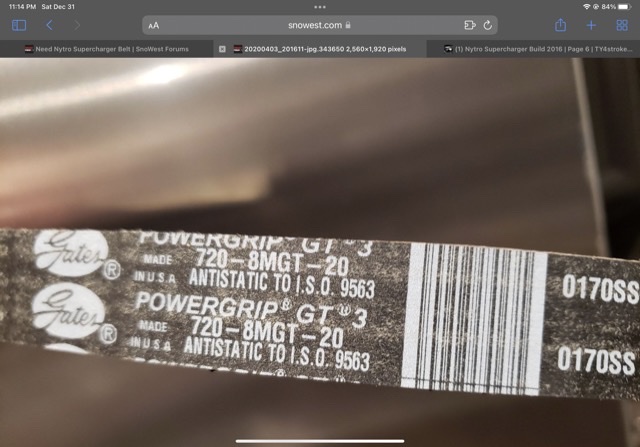

I no longer have the sled. I know its a gates belt. Contact Ulmer Racing, He may have them. @SrxspecWhat is the specs on belt or make of belt I need a replacement but can’t find any

a quick search and someone on snowest posted this. Gates powergrip gt3, 720-8mgt-20. They said this was the one purchased from Ulmer Racing…What is the specs on belt or make of belt I need a replacement but can’t find any

Awesome!!a quick search and someone on snowest posted this. Gates powergrip gt3, 720-8mgt-20. They said this was the one purchased from Ulmer Racing…

Looks like GT 3 series belts are now superceeded to GT 4 belts.

Ya I ended up getting a gates GT4 threw gates them selfs. The 720- 8mgt -20 but it keeps slipping my off my tensioner can’t seem to get it right on it seem other listings for 600 - 8mgt - 20 don’t wanna keep buying bets that don’t work
