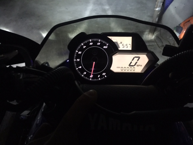

Took everyone's advice in doing this upgrade. Thanks to these threads, this was a seamless process. One thing I did that I haven't seen anyone else post was purchase a new OEM wire lead, cut one end off of each, stole a pin from a cut-off for the clock lead and soldered/shrink-wrapped the long sides together. (This gave me the additional length to get the gauge placement higher + closer.) Had a machinist buddy CNC the two panels, powder-coated satin black and picked up some additional OEM rubber grommets to mount both plates...bit pricey & time consuming, but worth it.
View attachment 115104 View attachment 115105
NOW THAT IS A SWEET INSTALL....

I did the same thing but didn't cover the loom with the nice grey plastic covering.
I bought the dual round end ram mount off ebay plus the big flat one and just reused one of the round ends as the backing plate for were it mounted to the hood cowling. Also reused the rubber grommets from the oem gauge. The ram mount make it so nice for adjusting it to just the right spot.
For anyone that needs an oem wire with pigtail for the clock PM me. I have a bunch!

I too got some CNC plates made up and mounted mine similar.
I love it. This gauge and the XTX suspension kit made my sled so comfy.
Now you just need to do my odometer trick to match up your miles!!
