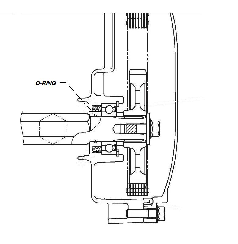

I started taking the sled apart to change track,and fix front w-arm ,I thought that I made sure I know were everything came from ,but after i got it apart I have an o-ring about an inch round and thin on the floor. So I want on yamaha micro fiche and there seems to be 3 and they all seem in place,but when I went on e-bay to order a bearing it shows 3 o-rings with driveshaft kit and 3 with jackshaft bearing kit how do I find out were they go??
I know that I had extra o-rings when I bought a Jackshaft bearing kit. Maybe each of your kits come with all the o-rings needed? Here's some section views that might help.

OK, I cleaned up the driveshaft section and I think there is only one o-ring in there.
