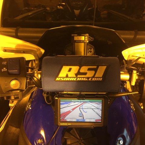

I added the OFT relocate and a 5in LakeEffectSnow riser. All I did was reroute the cable a bit and put it behind the bars.I will try rerouting it. I did adjust it as far as it goes. I think there may have been some ice build up that attributed to something being pinched.
mcamzr
Here is a pic you can kinda see the cable behind the nav.
