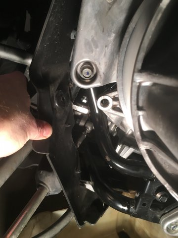

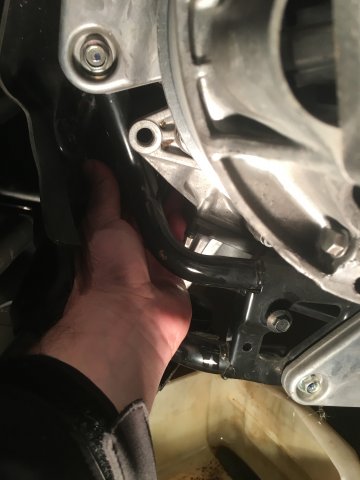

View attachment 122944 View attachment 122945 View attachment 122946 View attachment 122947 View attachment 122948 View attachment 122935 View attachment 122936 View attachment 122937 View attachment 122938 View attachment 122935 View attachment 122936 View attachment 122937 View attachment 122938 On my 2014 mp I chiseled off one rivet holding rubber/plastic couling by clutch/oil filter area. Now i can reach in with oil filter socket making filter change easy. I put a small self taping screw in place to replace rivet. Oil filter change is now easy.
going to check if this is possible with a phazer soon myself.

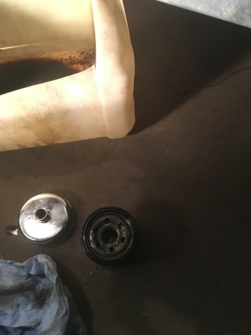

... oil change on my 2016 MP....once side covers/ air box was off, the filter was accessible ...but I needed a really good grip on it with a open jawed filter removal wrench...really chewed the filter surface up but never put a hole through it..cursed it a bit though....replacement filter used was a KN147 with 17mm nut on end..might make it easier to remove on the next change using an open/box wrench.. For oil I went semi synthetic...I usually go with the manufacturer recommended..in my MP for my temp conditions and use...Yamalube 0W-30 semi synthetic was used...
....I have the ultra plate installed on my MP ..I wasn't looking forward to taking that off since I had a bit of a chore lining up the bolts the first time installing it....however, second time around it was a charm..everything went back together easily..
