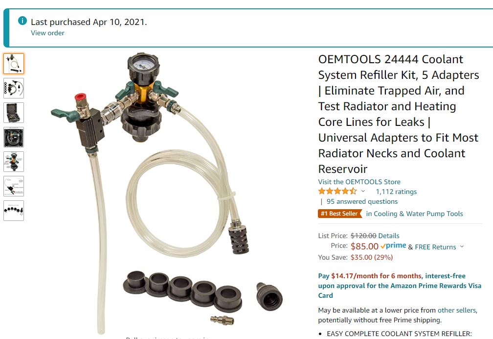

Is this something I can buy for this sled?
RobX-1
- 2,584
- 1,751
- Coldwater, OH
Something like this would work. I used to flush and refill the coolant in my 08 Apex but can also be used on cars and such.
https://www.amazon.com/gp/product/B01BW39HJS/ref=ppx_yo_dt_b_search_asin_title?ie=UTF8&psc=1
