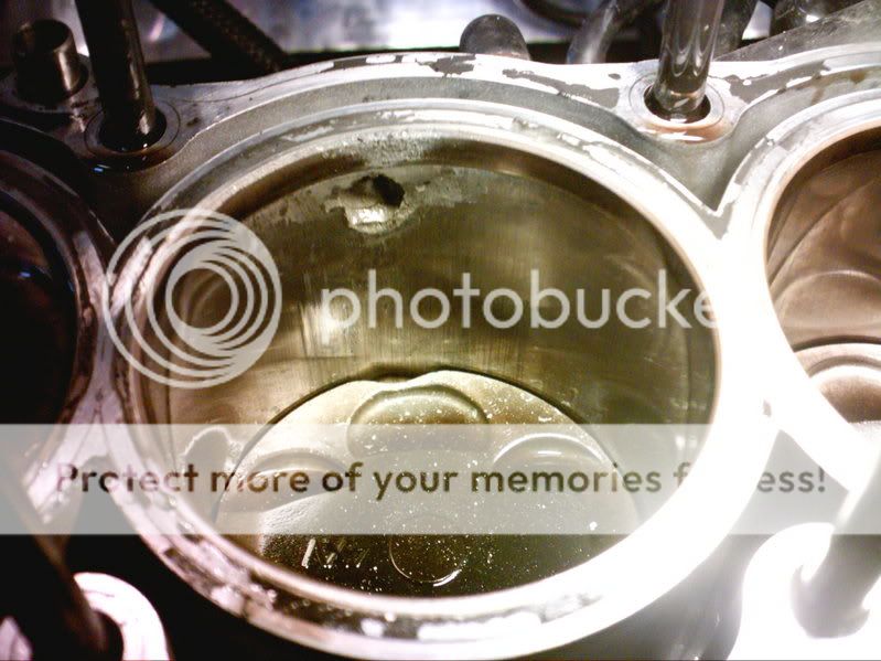

Bet it looks like this! Been there, done that, bought the T-shirt and the piston is hanging on the wall! LOL!

Took one pass and he said he has never been on anything that fast before. But it did the same thing as in that picture. Complete rebuild!

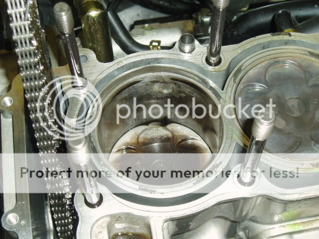

This one took three passes on high boost before it went down, spit oil all over, still seemed to run kinda ok when we loaded it on the trailer.

I'm not going to start it anymore, those pictures are scary and right now the turbo still makes that nice wind down sound when you shut it off.

I boosted my first 4 stroke in 2003 and this is the first one that's hurt. Probably from low octane. Anyone want odds that it's not just a stuck ring? I'll post pics when the motor is apart.
