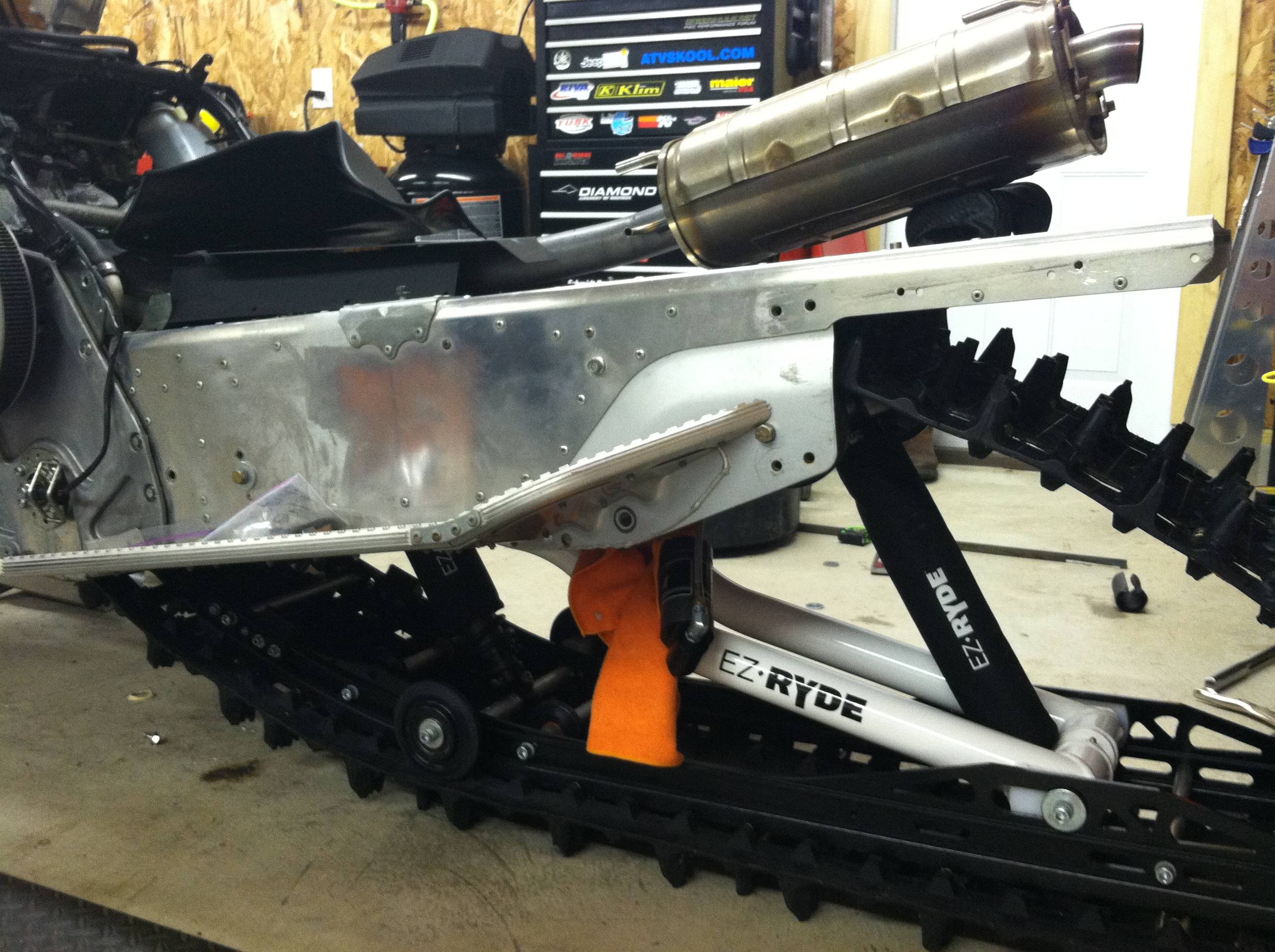

By the way...forgot to mention, EzRyde skid all in weighed 41.5/42lbs. dry/stand alone on the shipping scale. I also went with the Fox Zero Shocks with remote reservoirs.
Any way you could take a pic from the back? My only concern is it looks like it decreases the track clearance from the top of the tunnel.
Thanks!
I want to do this with a 136 skid. Would that skid mount in the same location as your 144? What track are you using? I ask because it doesn't appear to be cut down (at least I cannot see any signs of cutting). Looking good 550ss! ;)!
Lowedog, will take a pic for you tonight...I thought I had one on my computer, but didnt. But, I can assure you that this does not decrease the track clearance from the top of the tunnel. Good notice, but EZ Ryde's secondary shock mount utilizes a little smaller idler wheel than stock helping to remain more than enough clearance for a 2" track that Im running. I am fully confident that a larger lug will fit without worries back there. I think the main problem with large lug tracks on a phazer is more with the heat exhanger area IMO up front. With MTX drivers, you're good, but anything over 2.25/2.5" is tight for sure!

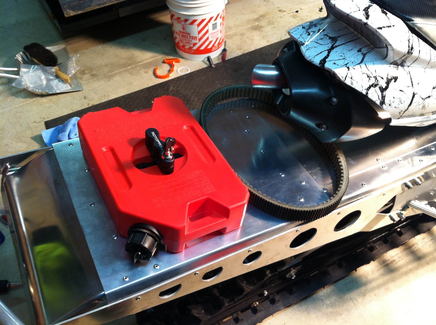

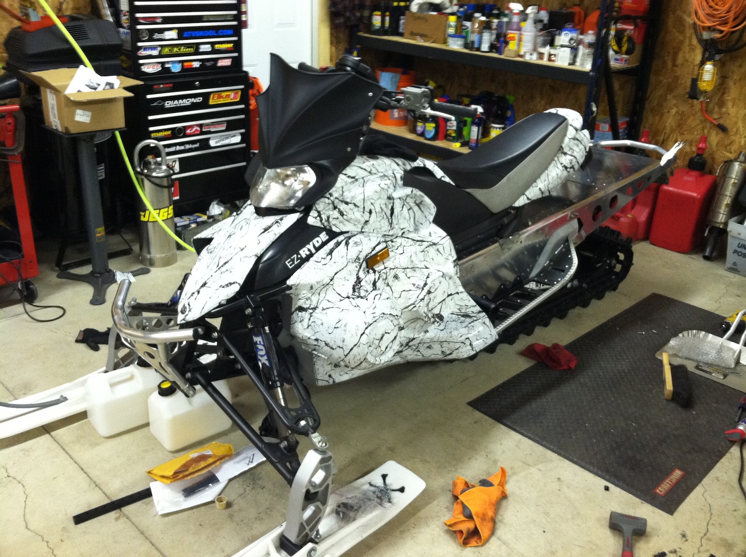

Well with work and the holidays, I havent been able to post pictures of the progress... but I wanted to at least post a pic of the sled 90% completed (before New Years) to get the topic flowing again. Waiting and praying for snow here in Ohio to test/tune the clutching, but I am confident in Chris at Schmidt Bros. for setting me up right on the Stage 2 kit. All in all, everything was a breeze and a lot of fun! After much back and forth on the gas can setup, I decided on the Rotopax setup.
Will post more pics of fit and finish this week, but just wanted to get the discussion started.
