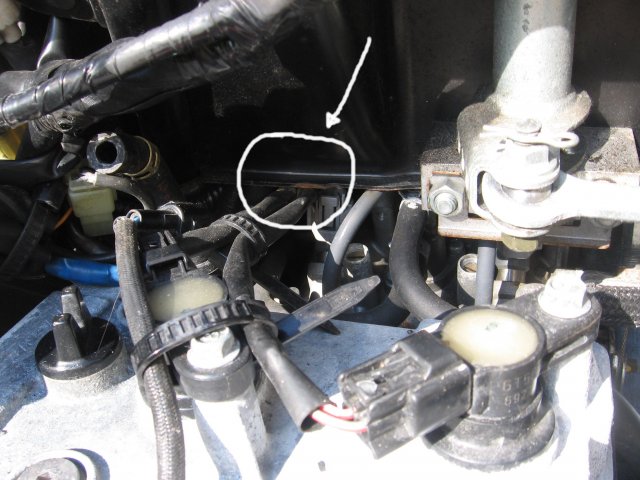

This reminds me of something I noticed on my Phazer a while back. I think of it every time I read about someone having an intermittent misfire/coil-type problem, but haven't been able to respond for one reason or another. Anyway, at some point I noticed that the two coil wires on my Phazer are fairly tight up against the bottom edge of the sheet metal portion of the upper frame/steering post mount. This edge was rather sharp on my machine, and I noticed that it had started to cut through the coil wire insulation, but had not got down to bare wires yet. This was with only around 750 miles on the machine, so I would imagine that it would continue to cut into the wires, eventually leading to a possible short/ground out of the coils, or something along those lines. I would think that it may not be a problem all the time (as long as the wires were not touching the metal frame), but could become a problem after some bumps, etc. Obviously this may not be the case in your situation, but it may also be worth a look while you have the fuel tank off.

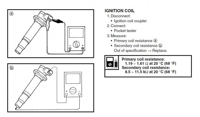

I think it was -37 with wind chill so in reality might have been -20. Machines are not affected by wind chill. Wind chill is the equivalent temperature felt on bare skin. Still weird if the fan was on.
Thank you for the reply.
Using a fluke 177 true rms multimeter at 20c exact.
I tested when I pulled out with different results at 28c. 1.5 and 10.02.
As they cool I'm noticing meter is bouncing between 1.6 and even 1.7 top end.

I did check and our harnesses are different. My wires go directly up to main harness up approx where the fuel return line is. Appreciate your post tho. It may help diagnose the next one in need!!This reminds me of something I noticed on my Phazer a while back. I think of it every time I read about someone having an intermittent misfire/coil-type problem, but haven't been able to respond for one reason or another. Anyway, at some point I noticed that the two coil wires on my Phazer are fairly tight up against the bottom edge of the sheet metal portion of the upper frame/steering post mount. This edge was rather sharp on my machine, and I noticed that it had started to cut through the coil wire insulation, but had not got down to bare wires yet. This was with only around 750 miles on the machine, so I would imagine that it would continue to cut into the wires, eventually leading to a possible short/ground out of the coils, or something along those lines. I would think that it may not be a problem all the time (as long as the wires were not touching the metal frame), but could become a problem after some bumps, etc. Obviously this may not be the case in your situation, but it may also be worth a look while you have the fuel tank off.
