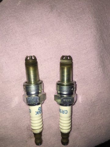

Got another stupid question.
Went and got plugs. Got br9's in error.
Another hour n half round trip and I got these. Didn't even open box. Assumed correct ones not remembering number off hand.
Just pulled in and not same number, nor tip. No plug head either.
Will they work?????
Will they work?????

Don't do it, don't do it,don't cave to desperation...Got another stupid question.
Will they work?????

Didn't do it.
Had to walk away, doesn't happen often but I had no wind in my sails and honesty I'm abit embarrassed to go back in, return set two and get set 3.
Make trip 3 to concrete village in the morning for 1 set of plugs.
Can't be mad at dealer there, anyone walking in should have everything in order before they order. Not the dealers fault.
