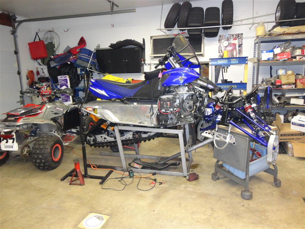

11800 mi and plan to keep the Phazer for that many more so it has come time for a full restoration. Starting at front.Balljoints which had the two piece aftermarket races were bagged out along with upper joints. Also had a bent upper left a-arm that I couldnt bend back.Also needed a filter change. Found a crack in lower oiltank mount so fixing that also.

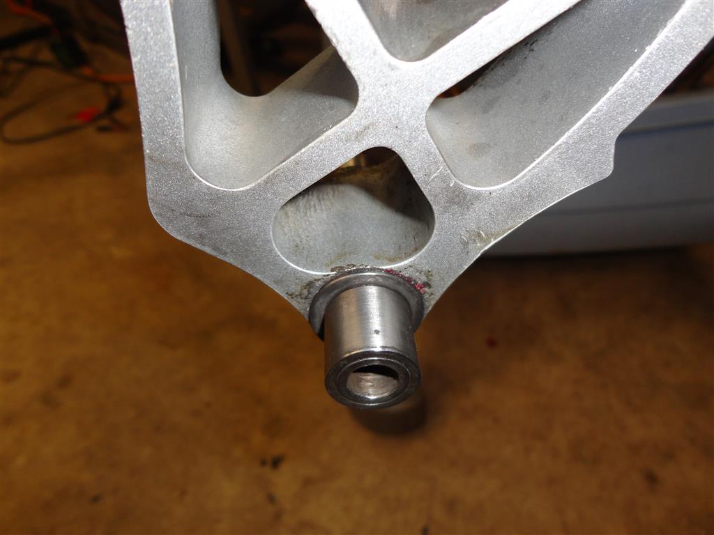

Found something to add to the Phazer factory changes thread. The upper balljoints from 07 which I did the handling mod of making them shorter the factory must have thought worked well since the newer joints are exactly the same length as the modified ones! Wonder if the Nytro guys know that? Learned that mod from them. Cool. I didnt have to cut them in the Lathe.
Stock/Old modified ones

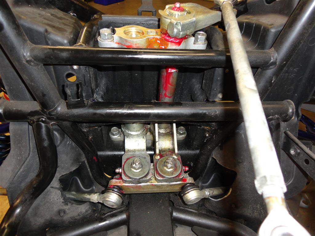

All the YFZ joints and grease fittings are doing there job no replacements needed. Is a UP Bushman kit in there also. Everything is as tight as the day I put it in. Awesome stuff UP Bushman! Job well done.
UP Bushmans spindle bushings are also well up to the task. Just cleaned and added some grease. Good as new yet! Front end done and good no BETTER than new! On to the rest.

Yes! My old knees wont take the crouching on floor anymore. Thankful for lift everytime I use it.

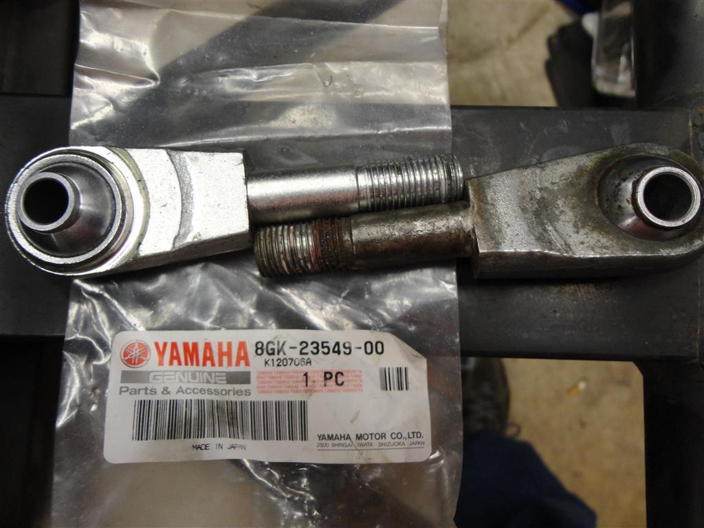

I've pretty much have my 07 completely apart and found some interesting things for a sled with only 6,000 miles. Discovered tonight when installing my new track that the drive shaft bearing on the chaincase side is completely shot. On inspection I noticed that the bearing (I think it's a 6205) had one side that was sealed and the other side open. the open side was facing into the tunnel. Doesn't seem right. #2 and #3 are the defective parts.
